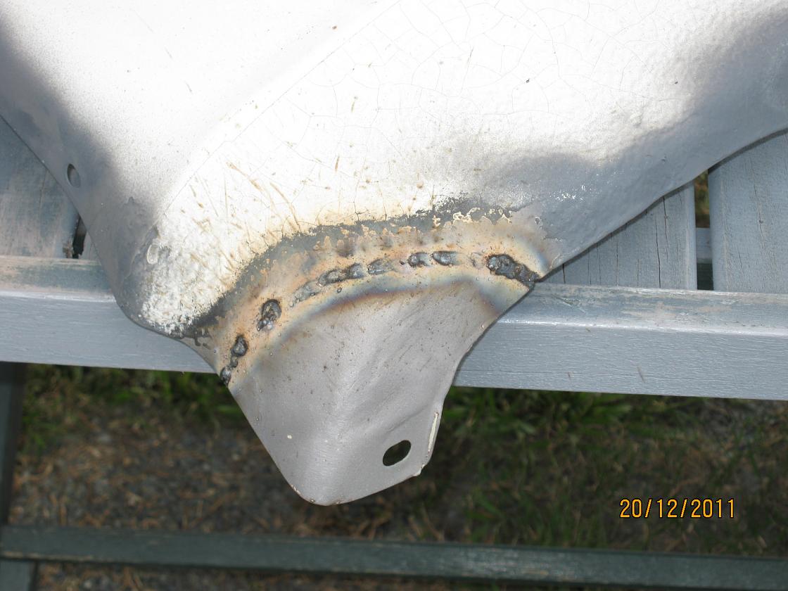

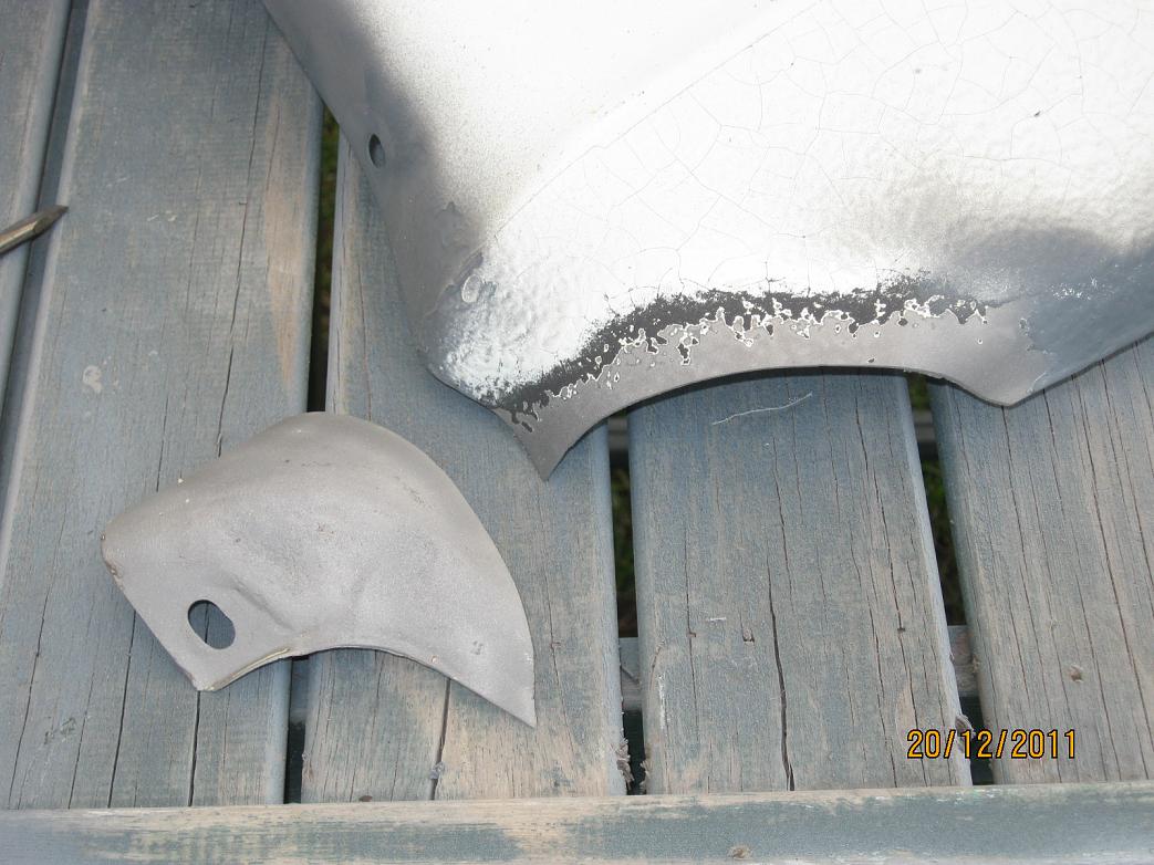

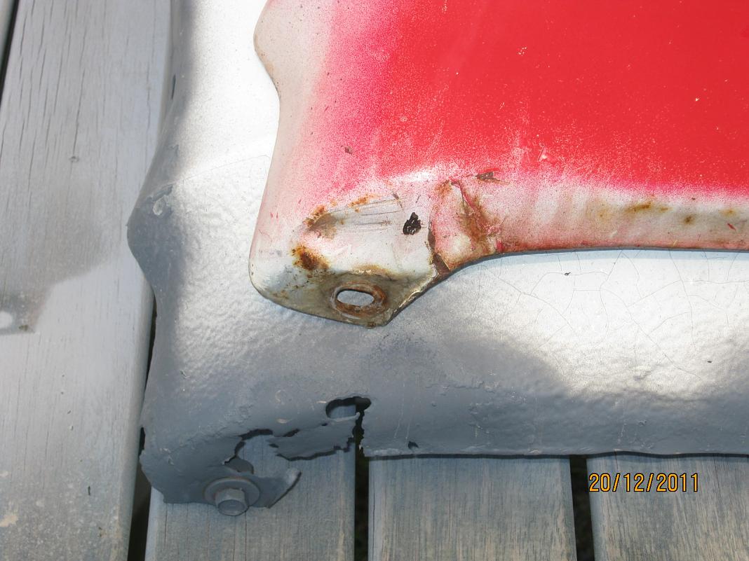

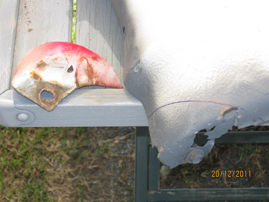

Almost threw out a damaged guard from a 84 Bum thay I wrecked but decided to hang on to it to practice spraying on.
Well part of that guard came in handy today to fix a guard i got off gannon.

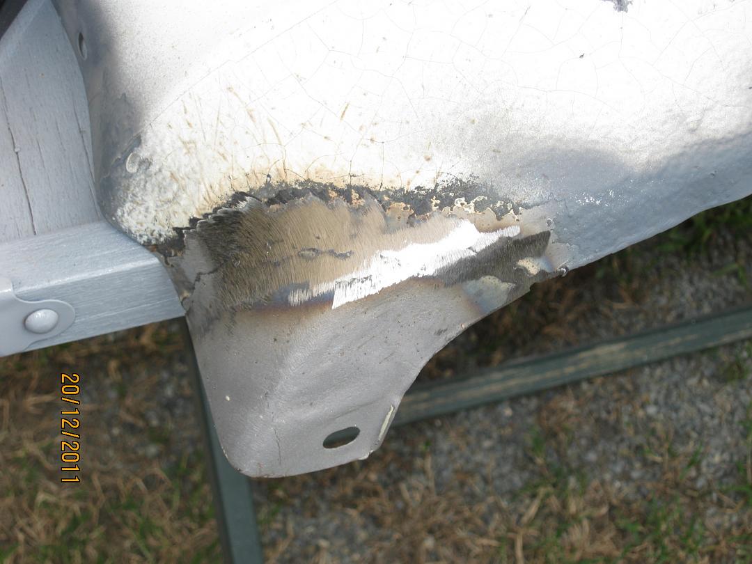

Blasted the steel where it was to be welded, (far out that makes a difference)Used a pneumatic angle grinder so I could control the speed of the 1mm cut off wheel. My gasless mig which I havent used in years had just enough wire in it to do the job, the elcheapo auto darkening helmet I have meant the weld started where i wanted it to and I don't have a big star in my eyes.
I'm so chuffed.
