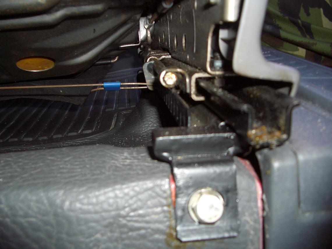

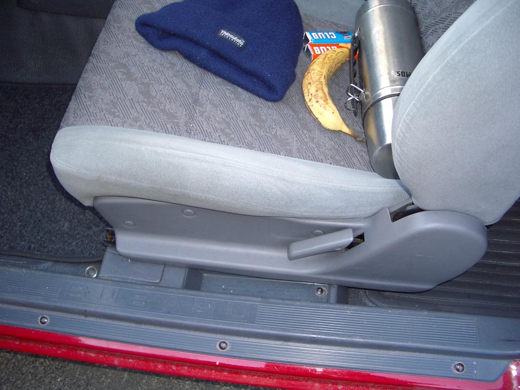

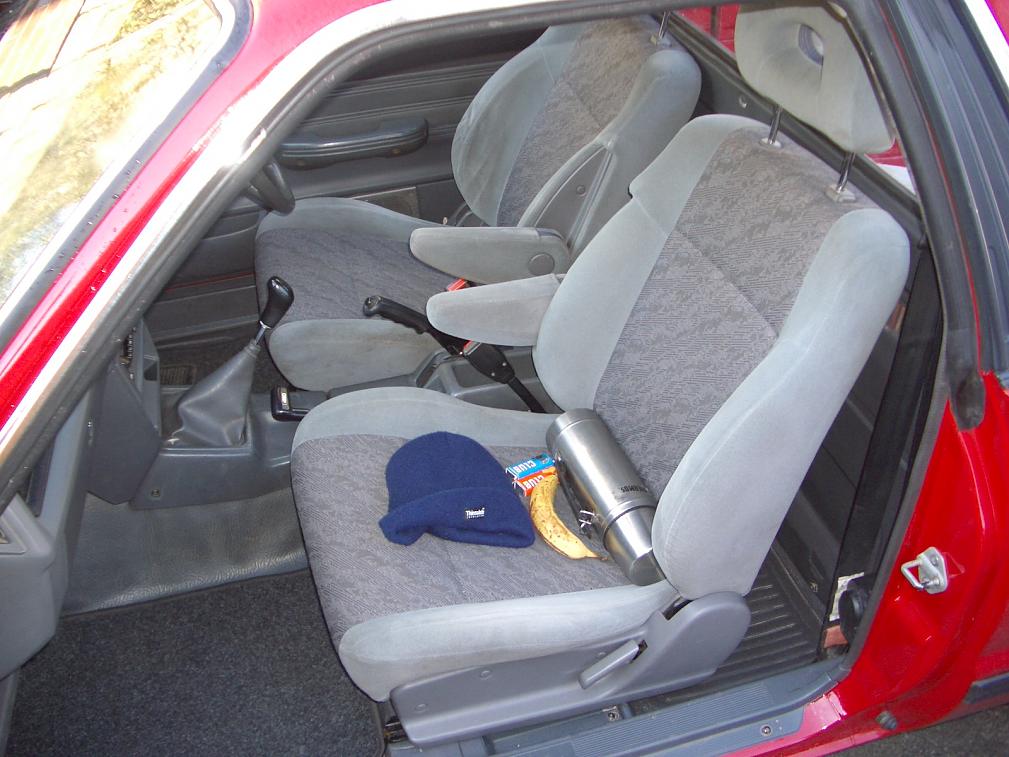

I took some snaps early this Sunday morning (very cold minus 3 deg & heavy frost). - but a beaut' clear sunny morning......at long last.
I was up early because I had to drop my daughter off at a local Gynastic's competition. It was then a race back home and load the bike and gear up into the truck.....and off to ride a trial near to Keighley.
I managed to picture the seats in the truck and the mountings which I have arrived at.
I hope this shows you that you can gain some extra inches. I'll try and get a mate of mine to sit in the cab he's a big bugger so I'll let you know how he fit's in - could be a week or 2 before I see him though.
You'll see the bike just fits sugly in the back of the truck.......

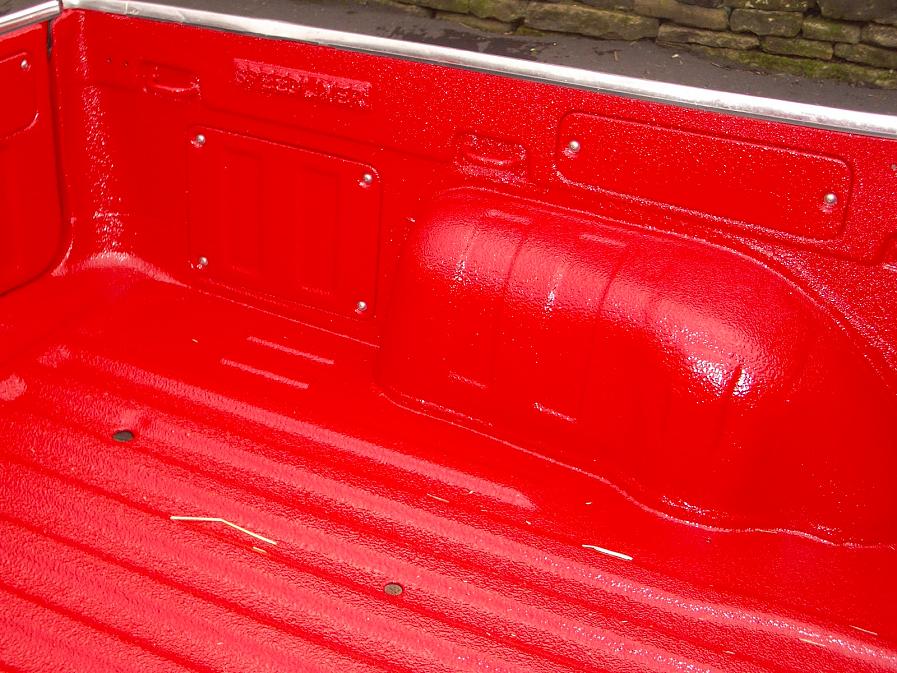

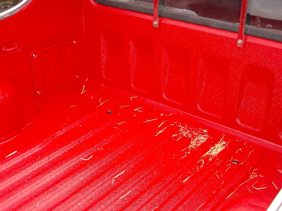

Hi - Well spotted, what you spotted is actually the repair of the wheel arches we carried out. Trucks here suffer from corrosion starting in the gap that's between the rear shocker hangers and the inside of the rear wheel arches. Typically caused by a build up of mud or if on a farm animal crap which is then kept damp by our rainy climate = corrosion plus add the dreaded road salt!!
Mine was no different in this respect.
Most guy's here simply slap on a plate on the inside and weld around it to effect a repair.
We carefully chopped out any corrosion in this area and then let in a sculptured copy cat repair piece we got it in snug and then welded fully round. Levelled it off and now it looks as original.
The colour differance you spotted is the temporary red oxide primer used to fend off any rust whilst awaiting the application of the spray on load liner, which is now on. The black is seam sealer.
There was no point re-spraying the butt to then cover it with the liner.
If you google speedliner or visit http://www.walkdengroup.co.uk you will see the kind of system used in my truck. I can recommend this approach as the tuffness is amazing!
Please see attached images of finished butt. Since pics were taken I have put the rubber bungs back in to the Butt bed holes.

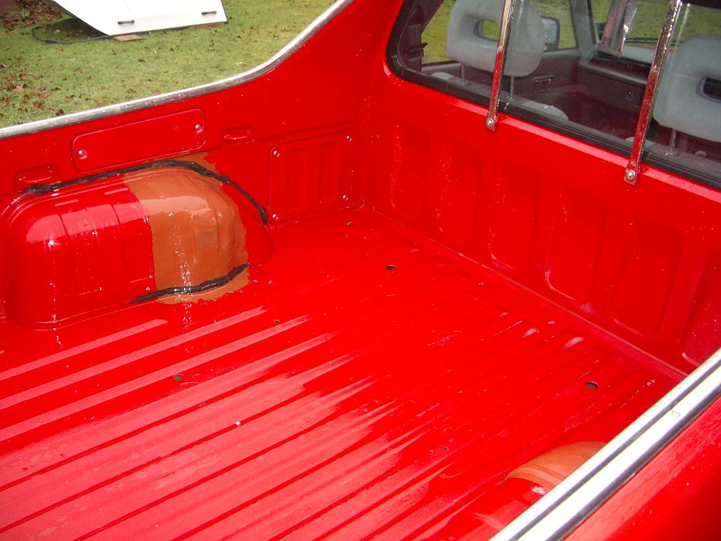

I can honestly say that the condition of the tray and cab bulkhead was as new. The original paint (which had lived all its life under a bone dry wooden load deck) was as glossy as the day it was applied ! If I can find a piccy I'll post it up.
ps sorry that the images dont appear straight away - and only as a click on jpeg. Am I loading them correctly??
Hey Just found a couple of pics which show what it was like!
