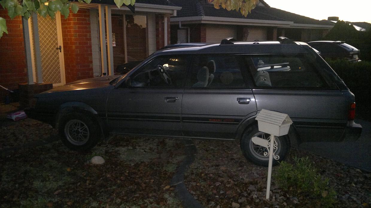

Meet Rupert, my 89 touring wagon, with many modifications to come

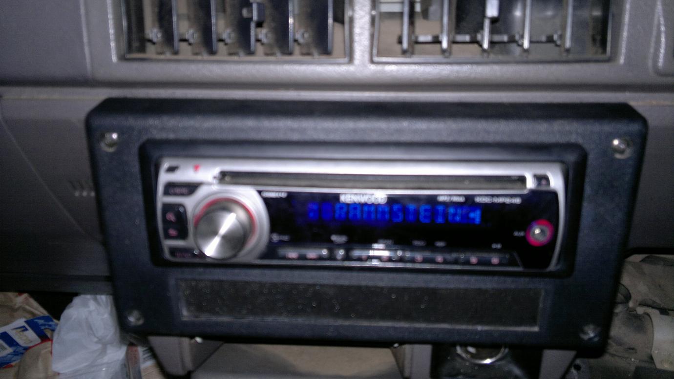

spent a few hours today putting a cd player and new speakers in. The facsia came from subareck, $15, and the new speakers (hidden in original holes) are 6 inch kickers. When i get around to it, i'll stick some more in the back

ok, seems a bit weird, the cd player keeps switching off while driving. The earths are good and main power comes directly from the battery. My only thought is i may have to rewire the yellow accessories cable. Thoughts?
Post by RSR 555 » Wed May 25, 2011 12:18 pm
Definately either loose connections or the unit is crappy
thelman
Posts: 155
Location: Blakeview SA
Post by thelman » Wed May 25, 2011 12:42 pm
good unit. Only bout 10 month old. Was working fine in the vt. Have done dozens of installs and never had the problem before
Posts: 12710
Post by El_Freddo » Wed May 25, 2011 2:44 pm
Or the ignition switch is dodgy on the accessories part of the switch. Check the soldering on the back of the ignition switch - you'll find it mounted on the passenger's side of the steering column at the back of the key barrel.
Otherwise check the connection you made to the wire the turns on with the accessories and see if its a good connection. I hope you used a decent connector or some solder and heat shrink!

Post by thelman » Thu May 26, 2011 7:42 pm
well it aint any of the connections, all have power even when its having its hissy fit. Alternator maybe? Any suggestions?

Post by Wagonman » Fri May 27, 2011 12:52 am
I know that when my battery and alternator battled against each other and killed themselves the radio was the first thing to start playing up.( i dont know why?? anyone?) I would be checking your battery and alternator..

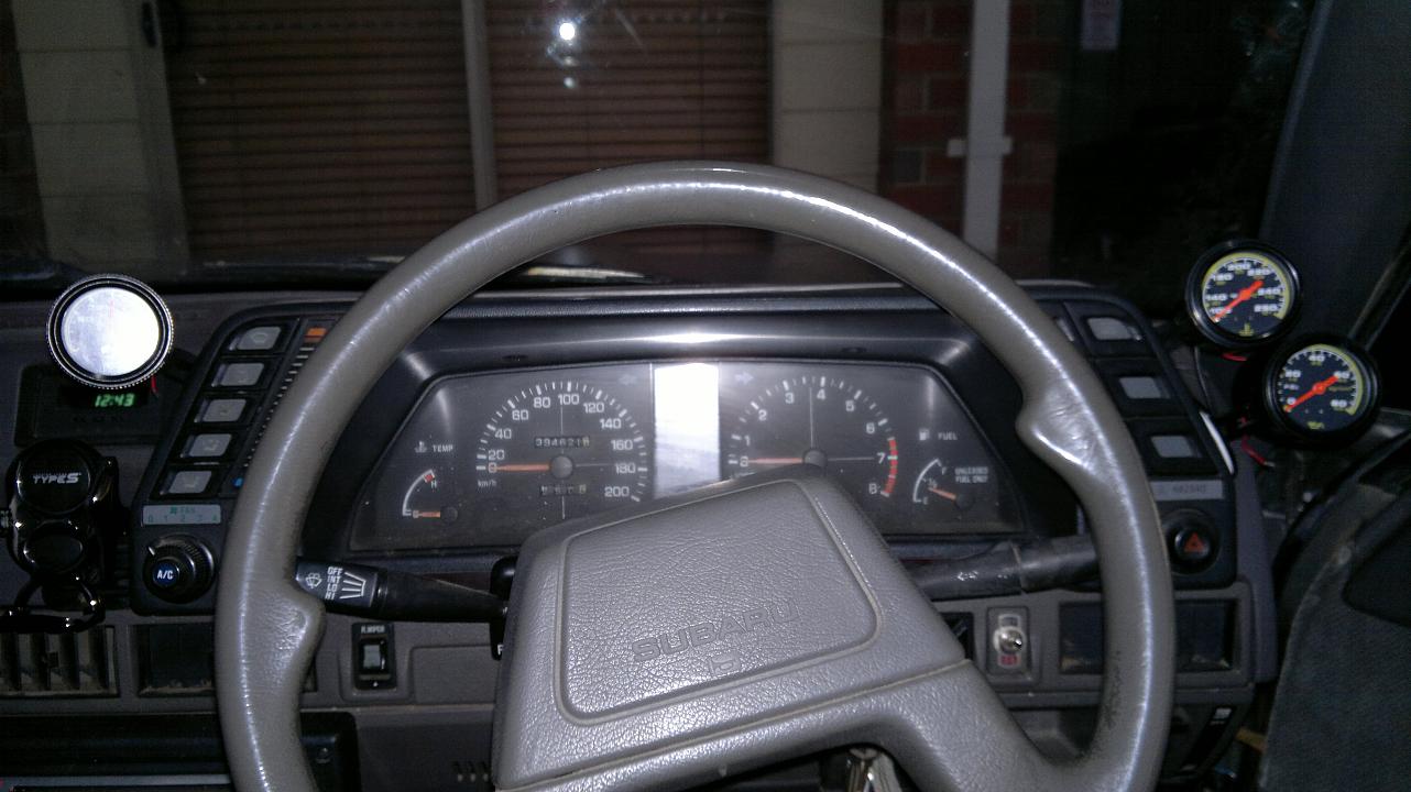

Post by thelman » Sun May 29, 2011 7:06 pm

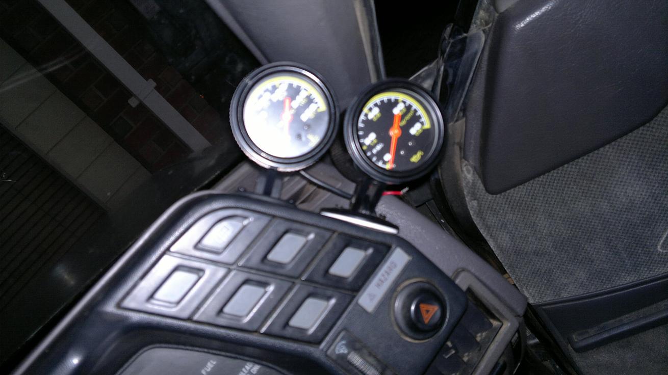

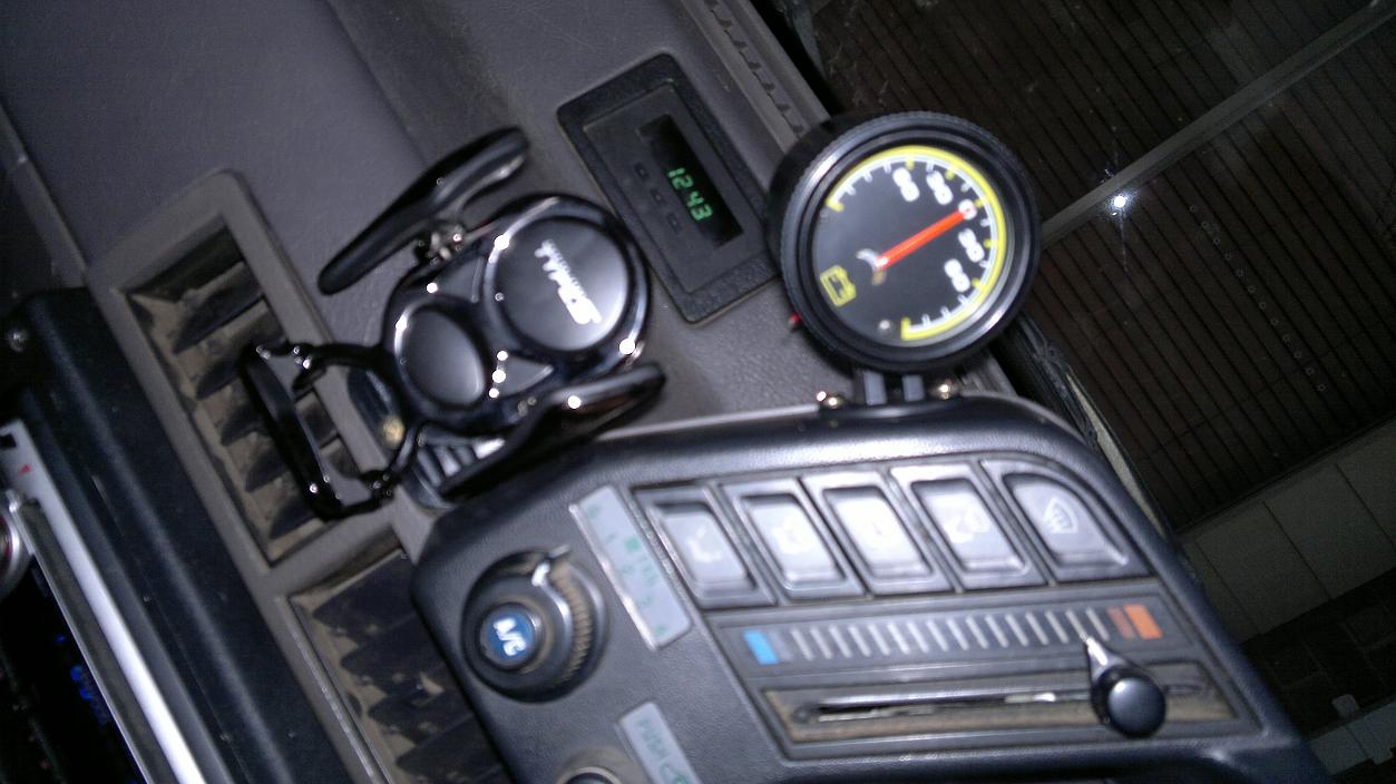

so today i mounted the gauges in rupert. Water temp, oil pressure and ammeter. Oil pressure and temp on drivers side and ammeter in middle. All are mechanical. Havent got around to wiring up the lights yet, but will do when i connect the gauges, hopefuly next weekend.
Gauge 2.jpg (102.66 KiB) Viewed 6604 times
Gauge 1.jpg (106.32 KiB) Viewed 6609 times
