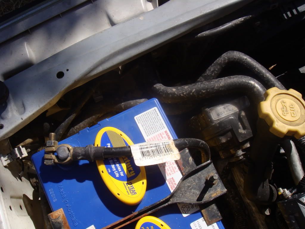

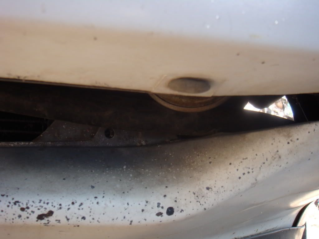

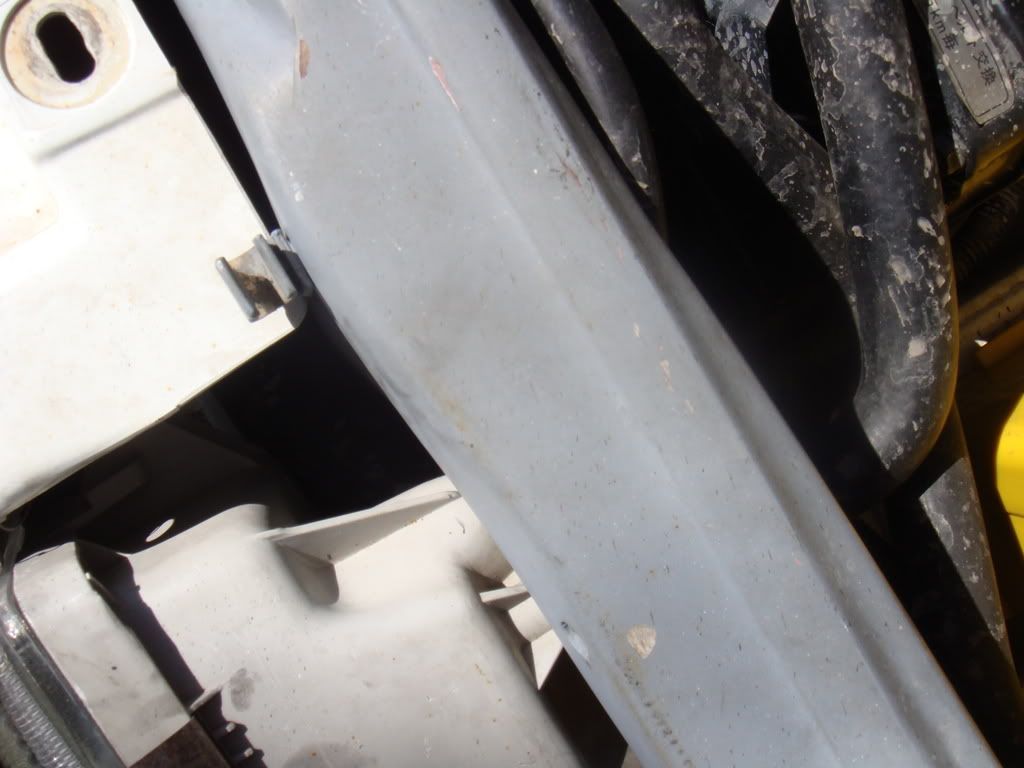

Well I got 15minutes of time out in the garage this afternoon to fiddle with the WAIC.
The following is a series of pictures where I have been able to remove the last of the air-to-air intake and move the WAIC unit around to see where it could be located.
The reason why it was sitting to high in the engine bay is that I still have the heat shield and bar still in the car (I assume that other without lift had removed this item?) You can see from the pictures it was ridiculously high.
On the spare wheel shelf.
Ideal WAIC Unit placement thus far appears to be with the rear of the unit just on the shelf and then I’ll have to fab up a little bracket and mount the heat shield onto the bottom (RHS) of the unit.
After AndrewT’s post about not having to drill holes I freaked thinking that I knew I should have waited to do this until final unit placement of the unit had been decided however after placing the WAIC unit in each position my only real option for the hoses to run is a few centimeters further (and backward) to the new hole and along the wheel arch. It would appear that if its not going there then its above the dizzy and beside the engine and this is not something I wanted. The saga continues...

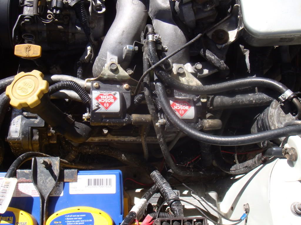

Ok i took some photos
This is the engine bay at the moment
This is a shot front on
This is a shot from the side to show how close i mounted it to the wheel holder
This shows the metal pipes i have running past the battery
Can you rotate the compressor housing on your turbo so it faces like mine, then you only need the original plastic turbo to IC elbow (or a 2" silicone bend) to join them up.
As for silicone parts, i got all mine from here Enthaily Wholesale - Blue Silicone parts
The prices are the cheapest i could find.

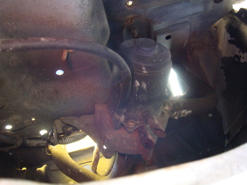

Suparoo wrote: Here is my pump
3. Outed or not, i used the factory RS bov cos the plastic elbow had the pipe for it. I really dont think it makes a difference where you put it. It also gives it a sorta factory appearance.

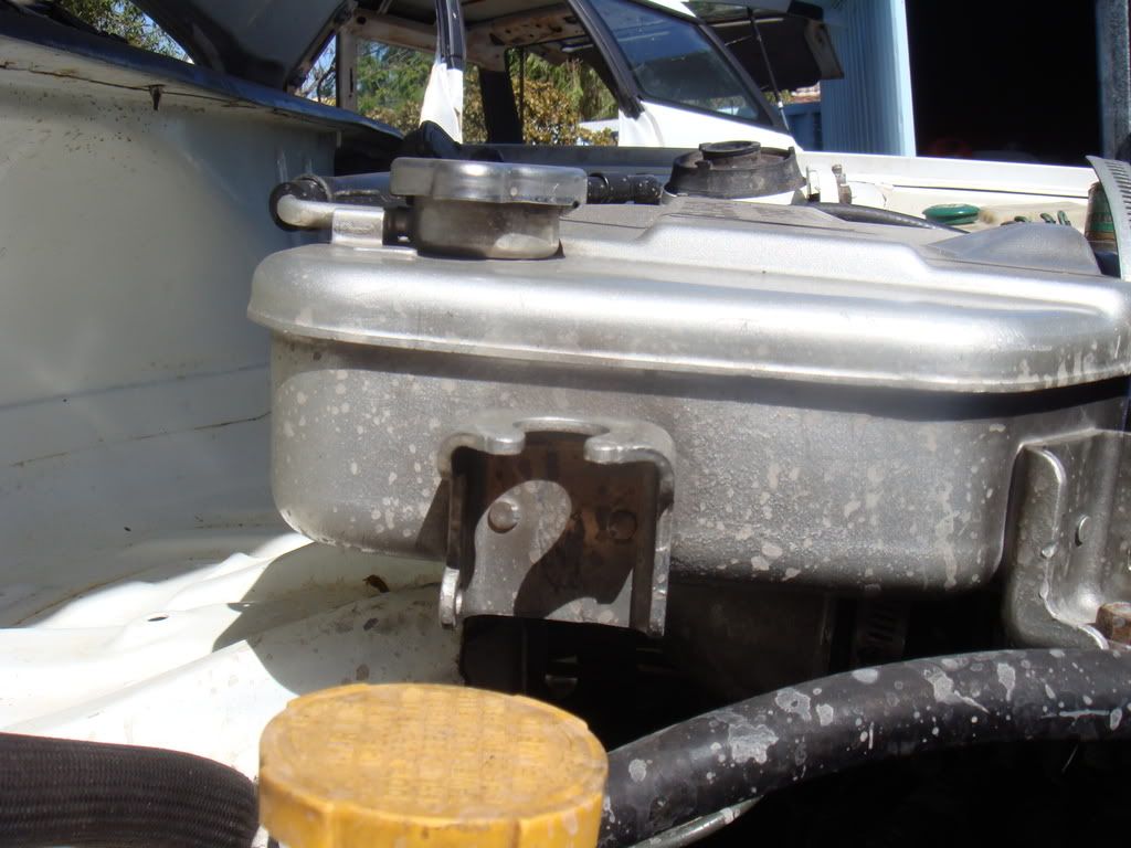

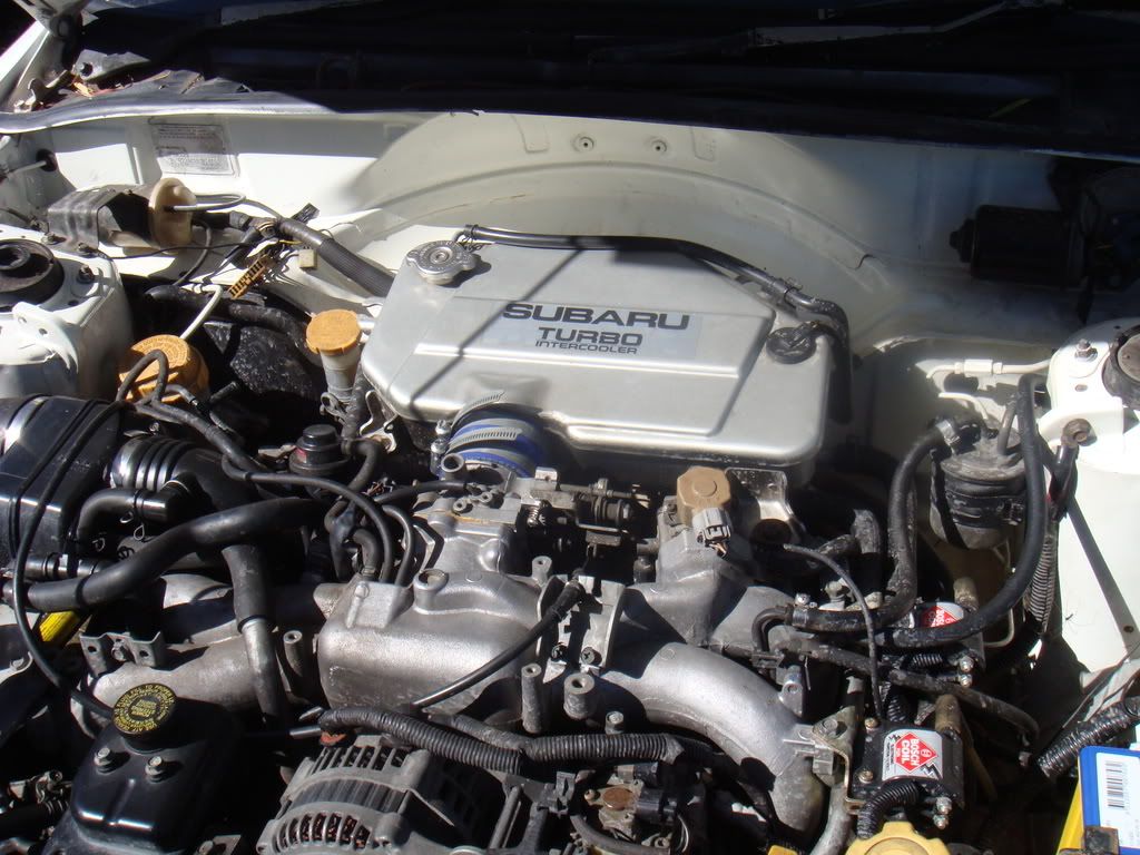

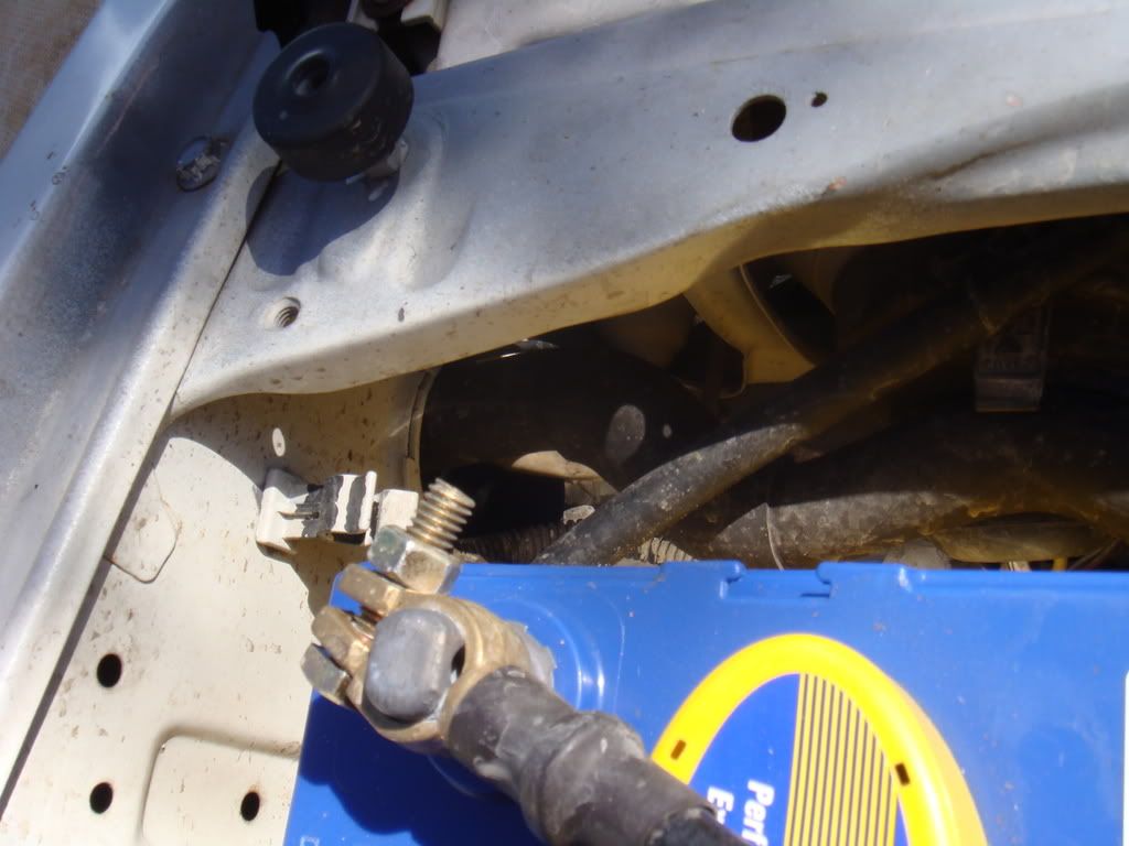

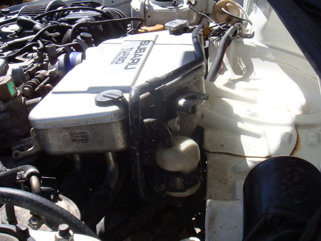

Heres the pics I said I'd take of my setup.
The intercooler heat exchanger mounts in the stock EJ position, some of the little ledge near the spare wheel well had to be cut away but not that much, hard to see in the pics but it clears it now, doesn't hit.
From the intercooler heat exchanger, the inlet and outlet hoses go onto the standard metal pipes that come with it (in my case bolted to the stock position on the inlet manifold - under the bosch coils in the photo). Then down near the battery, one of the hoses runs through a standard access hole in the passenger side of the engine bay and into the IC pump. The pump is mounted in the passenger side wheel well in front of the wheel (the standard RS mounting position). The other side of the pump hose comes out another standard access hole down below, above the front lower apron at the front of the car, tucks nicely behind the horn, then goes into the intercooler radiator. The other hose comes out of the intercooler radiator and goes through the standard hole where the L series headlight mounts (there is just enough room for it to squeeze past the light). Then it just connects back to the other standard metal pipe and goes back up to the heat exhanger. Hopefully you can make out it's route in the pics.
But yeah, in your case Craig the actual mounting of the heat exchanger should be the only customising for you to do - and I don't know how much room you have with the EA82 there but surely you'd have a little more than me with my EJ? Also the mounting of the metal pipes...the EA82 manifold obviously won't have the standard mounting points on it - I guess you don't really need to use these pipes anyway but it does make things look nice and neat.
The rest of it should be able to mount roughly like mine which hasn't required any cutting of the body at all. I think I just needed to drill 1 hole where the intercooler pump bolts through the side of the engine bay - it mounts with 2 bolts and I used one pre-existing hole.

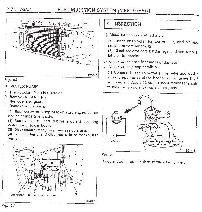

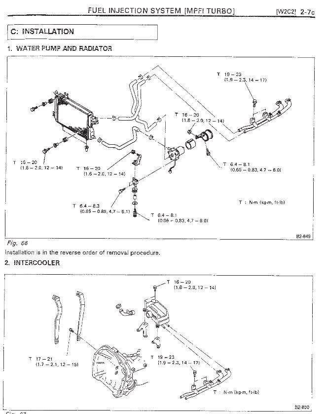

I do have a newbe question though and that is what is the direction of water travel through the WAIC?
AT this stage i THINK i have the water traveling from the radiator into the end of the pump and out through the bottom then towards the WAIC unit - this bit kinda seems logical (take cool water back to WAIC Unit) so i hope its correct.
However does it matter which way it flows through the unit itself? Should the cooler water be traveling IN the front or rear pipe on the WAIC?
Also am i to assume that i can run an engine anti freeze/boil coolant in there as well?
Cheers (and i'll get some pix up soonish for those interested).

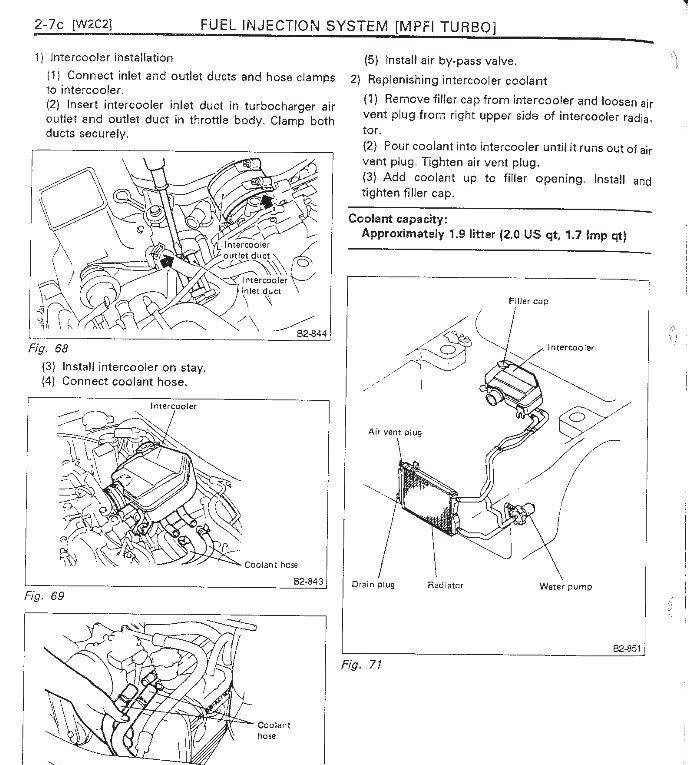

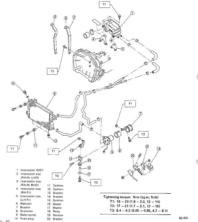

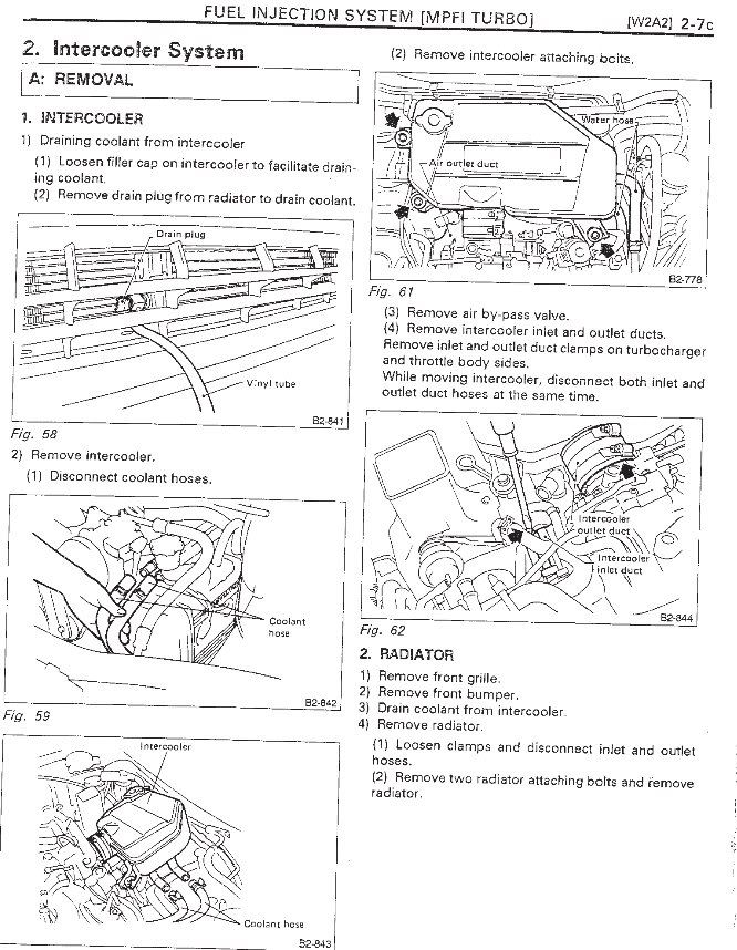

Post by AndrewT » Mon Feb 16, 2009 11:32 pm
Use normal coolant like you put in the engine.
If in doubt of how to plumb it up....just do it like Subaru do. It always works best :)
The stock hoses should have flow direction arrows on them but you may be missing these hoses.
Here are some diagrams and general WAIC service info from a Legacy workshop manual;
http://i286.photobucket.com/albums/ll11 ... inWA/1.jpg
http://i286.photobucket.com/albums/ll11 ... inWA/2.jpg
http://i286.photobucket.com/albums/ll11 ... inWA/3.jpg
http://i286.photobucket.com/albums/ll11 ... inWA/4.jpg
http://i286.photobucket.com/albums/ll11 ... inWA/5.jpg
Hope this helps.

Cheers AndrewT, as I said factory/Fuji is best that is exactly the information I was looking for. However I still have a question… I am yet to read all the fine print from you links however have you noticed that link 1 and link 5 are actually plumed up differently?
Not having access to an EJ with a WAIC does someone want to tell me which method is correct?
Post by AndrewT » Wed Feb 18, 2009 12:17 am
Well spotted, I hadn't noticed that.
Just checked my car, - for 1 example the connector at the TOP of the front radiator goes to the REAR connector on the heat exchanger. The direction of flow is from the radiator to the heat exchanger. Mine seems to work correctly.
Yeah definitely best to check on a stock RS to be certain, hopefully someone posts up :)
