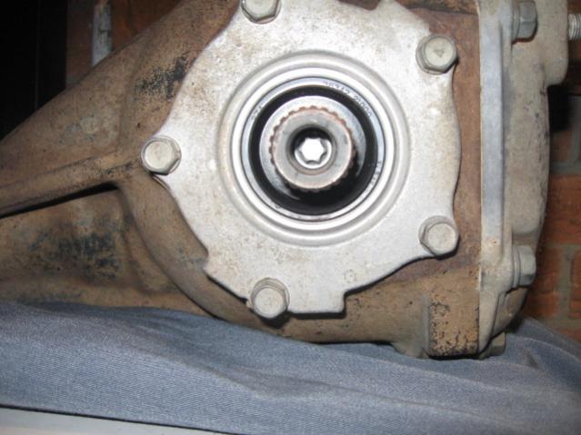

Post by FujiFan » Wed Feb 02, 2011 7:33 pm
Just had a look at an R160 happen to have close to me (Open not LSD), appears to have some kind of tamper proof bolt, similar to torx.

H-top
Posts: 782
Post by H-top » Wed Feb 02, 2011 7:50 pm
unfortunately it is nothing like that.
there is a 4x5mm hole in the center with nothing in it!
must be clips somewhere?
