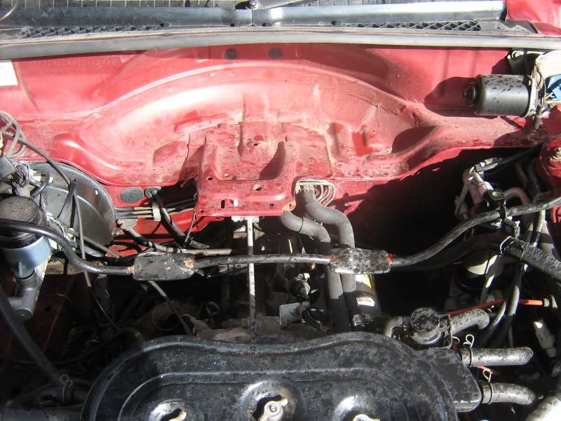

^ It looks like the pre-heater equipment is intact, minus the hoses. Am I missing anything in the air-cleaner box?
http://s92.photobucket.com/albums/l9/He ... tos008.jpg
^ Here's where the pre-heater hose is supposed to be...
Makes me wonder if it'd be worth rigging up my own cold-air intake. :???:
Right now all it gets is hot under-bonnet air it seems.

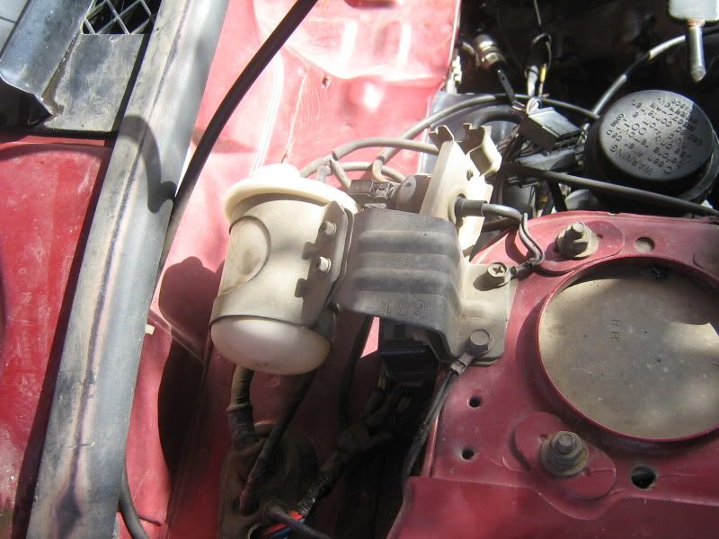

1) What is this small white cylinder?

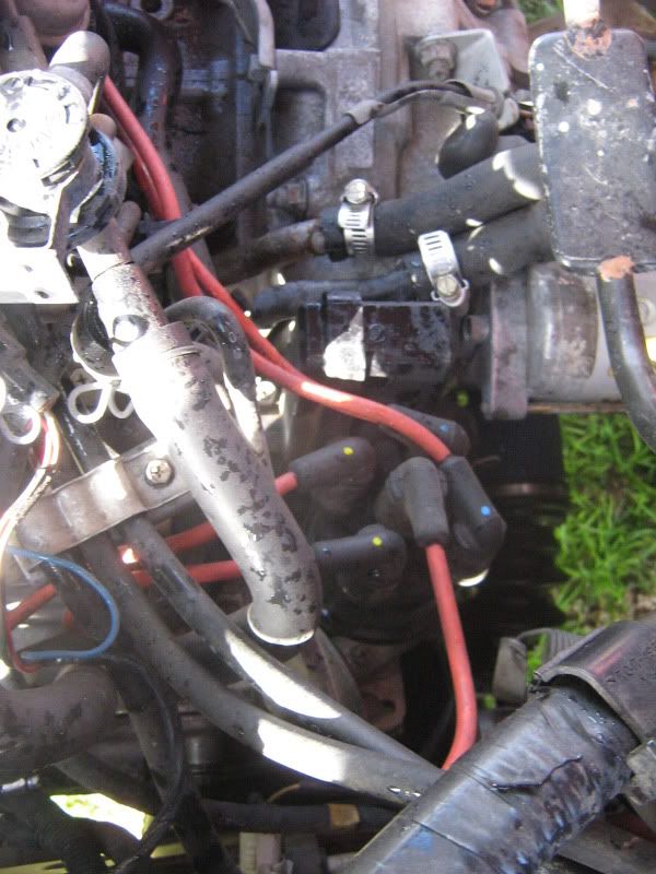

2) This appears to be the distributor, but there's something else almost identical

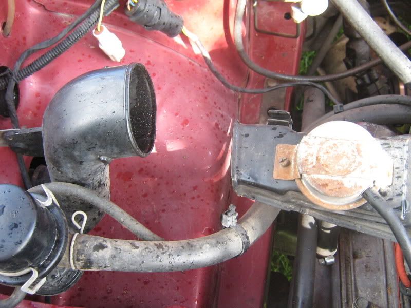

3) This is the distributor look-a-like. What is it really?

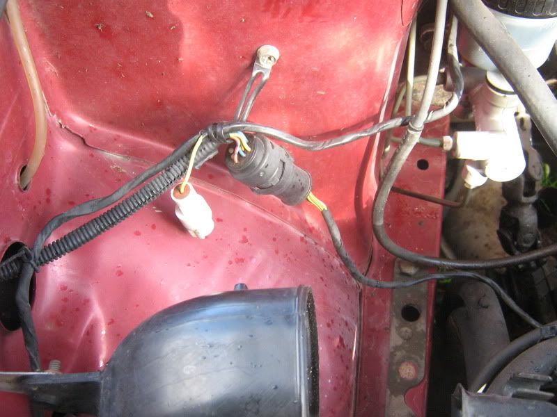

6) This black cylinder on the firewall... is it a solenoid? what does it do?
7) A spare electrical connector! What does it look like it's for? Can I add driving lights with this? :D
#8 Towards the bottom left you see the hole that is probably for EGR, with the conneting hose missing. Would I need a hose to pass rego in a different state, if I want to move?

The mystery canister with the sight glass is the receiver-dryer for your air conditioning system. Your "distributor look-a-like" is the charcoal canister for emissions. The black cylinder on the firewall is actually your windscreen wiper motor. The white cylinder (small) in the first photo is your fuel filter I think???

^ You just need the chunky flexi hose that joins the two here. Hot under bonnet air is not a bad thing in winter! Summer it will be but most will still run ok like this...
The white cylinder is your vacuum reservoir for you cabin air ducting etc.
This is your distributor with the coloured dots on the wires that clip into the top of the dizzy cap. The next pic in the album is as Phantom D says - charcoal canister for emissions gear.
Next two album pics are as Phantom says - AC gear.
This is the wiring for your gauges and the power to the solenoids on the carbie - anti dieseling and most likely the auto choke too I think.

the last pic the hole is for the carby preheater hose you will need it in really cold weather and to pass registration. it goes to the bottom of the air cleaner
it is a sort of corrugated pipe. I used an air con ducting one but it melted off. not really necessary in west australia the lever thing on the air cleaner for summer/winter running is fed by this.
