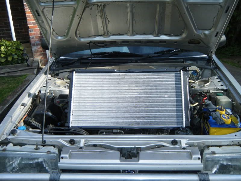

i am at the point of needing to make a decision on what radiator i will use to cool the EJ22, and as it stands i can see 3 options.
1. go new standard L series rad. some people suggest that this isn't enough to cool the bigger engine on a hot day 4wding.
2. aluminium L series rad. these are meant to have better cooling than the standard ones, and i think this option makes the most sense. (i guess i was partly wondering if i can just grab something off the internet, or if i need to go into a radiator shop and explain/order what i need :confused:)
3. get something custom made up :twisted:. this, i have no doubt, would keep the ej nice and cold but would also cost a lot more and is probably not necessary.
i will definitely get a new rad, as i have no idea how old the current one is but being in a 20yr old car i would be mad not to replace it.

Go single core alluminium. Its nice and thin which means you could probably fit a much bigger thermo fan than you can for a dual or triple core. Its cheap. Its works for every EJ, a stock Ej22 single core radiator keeps my H6 cool with no problems. I'd recommend a H-piece or two T pieces to bridge between the two heater core hoses, that way if it gets blocked you still maintain flow.
Every time my car(s) have heated off road its been due to a lack of airflow, and in my opinion thats best addressed with as much pulling power from your thermo's as possible. The bigger rad reduces the size of the thermo's you run, which to me is not addressing the problem you're having. If you have no AC then maybe go a dual core and fit a massive single fan on the front.
I'd really like a dual thermo fan setup with a full shroud covering the whole core, to me that would be the best cooling setup.

I bought a Nationwide Auto Parts radiator off eBay for $160 delivered. It's ok so far but I have not taken it on the beach yet and Tassie hasn't exactly got warm yet! :P
With normal driving it site about 3mm above the line on the gauge and rises up to 1/4 on massive hills, using the stock fan and unknown condition fan clutch.
I'll have to find out if the factory fan clutches can be opened up and I might put some Toyota fan clutch fluid in it to recondition it.

So a single core, perhaps aluminium and some better shrouding for the fans would be the best for my L Series?
It sounds like one of the cheapest ways for good cooling. :)
Posts: 12639
Post by El_Freddo » Wed Dec 07, 2011 10:34 pm
Fan shrouding is key to good air flow through the radiator. You need the shrouding to be flush with the radiator core/cooling elements as a fan will naturally pull air from around it if there's not shrouding.

i like the idea of a dual core, simple because it in creases the amount of water the system can hold. Ali is the way to go, i dont know many people still using copper in anything.
Oil coolers are deffinatly a plus, first thing you should do if you think its getting hot, however it lowers oil pressure and oil coming out of the cooler is 60 percent air and roots bearings. If your running a front bar can i suggest fitting an oil cooler the size of your number plate, sited behind your number plate, if your doing hard work move the numberplate to the lower holes.
Keep the clutch fan as long as you can, my thermo fan is hooked up to the ignition always on and never lets the car down. Shrouds are nessecary, if your running thermo fans only go with an air evacuation sheet (fancy word for a big shroud)
I will have to do somthing about mums cause its boiling its nuts off..........
Also dont jack the bonnet up for better cooling, it doesnt work it creates a low pressure zone and sucks more air in. Best bet is to vent somwhere else (i will be doing some experiments about it)

I ran with one Paul's dual core on my NA L and then the EA82T. Unfortunately, they are not very robust - mine was dinged up too easily as per avatar(!)
Setup: Had one fan with a shroud, one without. Quality waterpump (not all waterpumps are =) - all standard. Very good coolant mixed correctly.
No fancy fan switching, no Homer go fast vents, no mods aside from the rad itself.
I recall only ever once overheating in the EA82T - suppose though towing another vehicle backwards on shell grit beach on a balmy 35C day down at Beachport one summer will do that
A standard cooling system in good order, good coolant is a good start before dual cores, oil coolers etc. I would suggest a fair percentage of cooling systems have issue(s) before they are stressed by what we do...

discopotato03
Posts: 2134
Location: Sydney
Post by discopotato03 » Sat Dec 10, 2011 10:55 pm
Col makes sense there but note he is talking about a dry sump race application not a wet sump road one .
Not sure if you know but dry sump systems use basically a shallow tray on the bottom of the block to collect drain back oil and its removed from here by a scavange pump and sent to an oil tank or reservoir .
With the sort of revs many race engines run there is a lot of "windage" off the crankshaft and "crank scrapers" are used to try and seperate the oil from the cyclonic currents in the crank case . I believe some of this ends up in the oil tank though its probably possible to make the oil spin radially in the tank so the lighter air moves to the center and rises to the top .
BTW where he mentions keep Duckworth poor I'd say hes talking about Mike Costin and Keith Duckworth who together formed Cosworth many years ago .
A .
spike
Posts: 1153
Location: gawler south AUS
Post by spike » Sun Dec 11, 2011 7:13 am
yes there are differences between race and road but id still believe it about the aeration because think of what will happen if we dont, better safe than sorry
