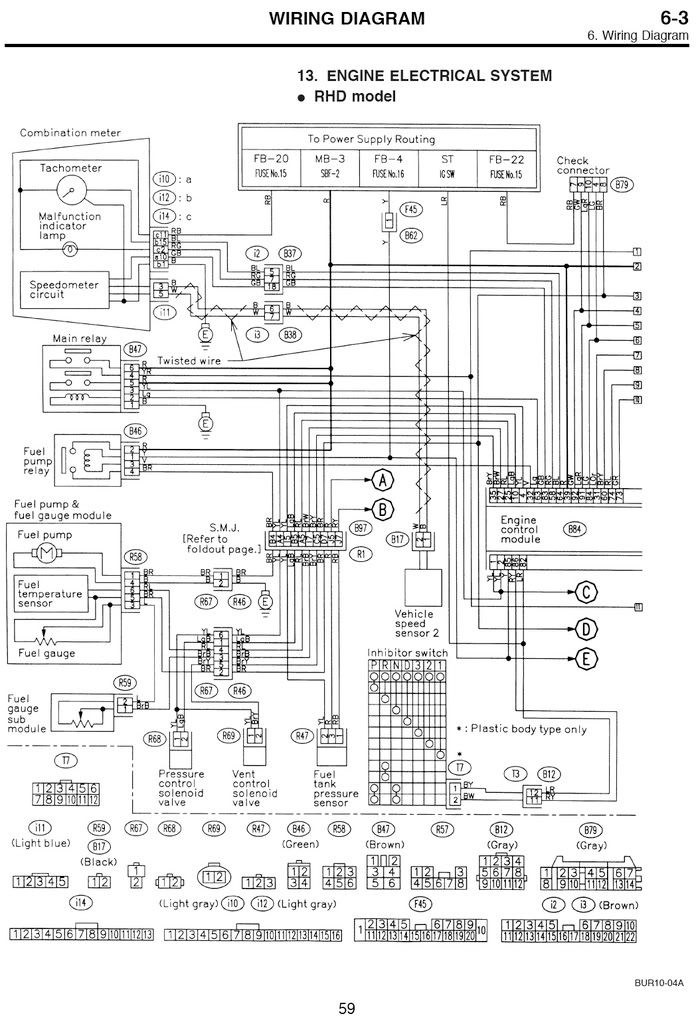

Post by AlpineRaven » Sat Dec 29, 2007 12:17 pm
Yeah I have it here, yeah it is, just wanna talk about it here, havent had the chance to solder it all in, might do that in this afternoon...
I have located the wires on Subaru Electrical Diagram for 96 Legacy, its showing black and white wires, I am assuming to use white wire as its positive feed? I am not very sure which to cut.

Post by AlpineRaven » Tue Jan 01, 2008 9:25 pm
here is the diagram - I suspect its white and black wire there (its twisted wire), Its same colour on the wires from the gearbox in engine bay that I checked out...
Which wire should I cut - white or black?

Post by vincentvega » Tue Jan 01, 2008 9:35 pm
at a guess.. the white wire
the speedo pickup will be switching the signal wire (white) to ground (black) each time the speedo gear moves past the sensor.
from what i have seen of subaru looms, i would be very surprised if the white is the earth, and the black the signal
Post by AlpineRaven » Tue Jan 01, 2008 10:27 pm
vincentvega wrote:at a guess.. the white wire
So if i get multimedia and check if there is an circuit with the body - there shouldn't yeah?

Post by vincentvega » Wed Jan 02, 2008 8:39 am
if you can do that with multimedia i will be impressed ;)
unplug the speedo sensor from the box and measure the wires resistance to the chassis. black should be close to zero

Post by AlpineRaven » Wed Jan 02, 2008 11:17 pm
Yep. Correct black was the signal wire, its now fitted in my Liberty - very happy with it and its spot-on with GPS and I went under speed check it was correct. Thankyou once again. I will write up an technical part of how to do it and place it in Wheel section or electrical section?
