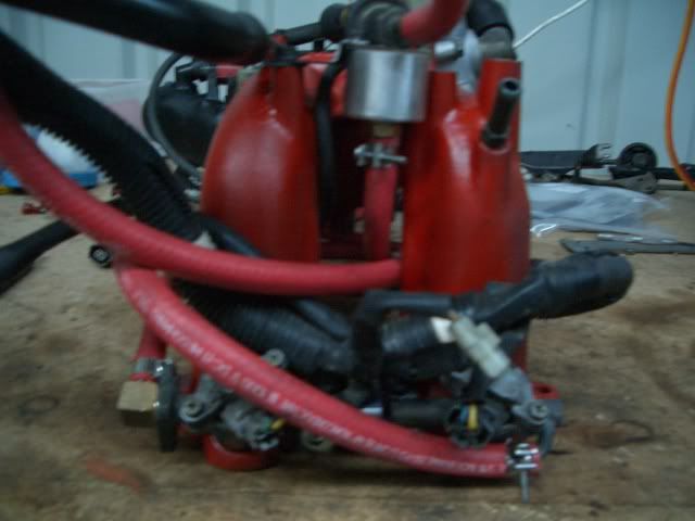

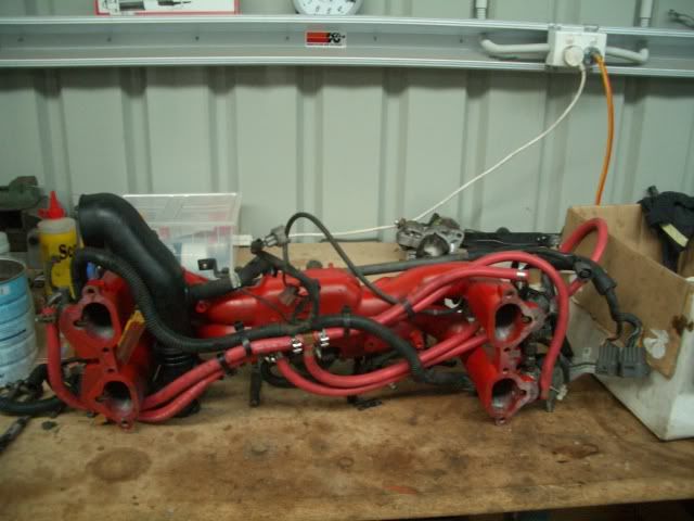

Here's how I have done it this time. There are plenty of ways to do parrallel rails but basically you just delete the regulator and put a T piece in both the inlet and return lines. The pics aren't brilliant.
You can see the two t pieces here.
And here you can see one rail and the std reg adapted into an alloy block. You would not need this if you are using a Sard reg.
I used 1/4 BSP brass fittings and tapped one end of the rail(the other end of these LH TT rails has a std 8mm barb).
