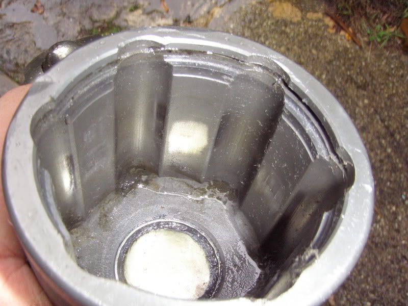

There is only retainer ring in the inner CV joint and a circlip to hold the the bearing cage runner (the star shaped part) on the shaft.
Before you rush out and buy another set of shafts pull one down and see what the condition of the bearing cage runner (the star shaped part) is
have a look at this picture
In the case of the star above I wouldn't use it again due to the damage on the outer faces. I've used the only photo I could find on the internet :) if it was confined to the inner curves the star could be used again.
However notice that one side of the inner curves of the star is flogged but the other side is near new. the star can be rotated on the shaft and used again, with the same cup and bearings provided the cup looks no worse than this.
If you find the inner joint is beyond repair then you will need to look at either re-manufactured joints or new joints.
