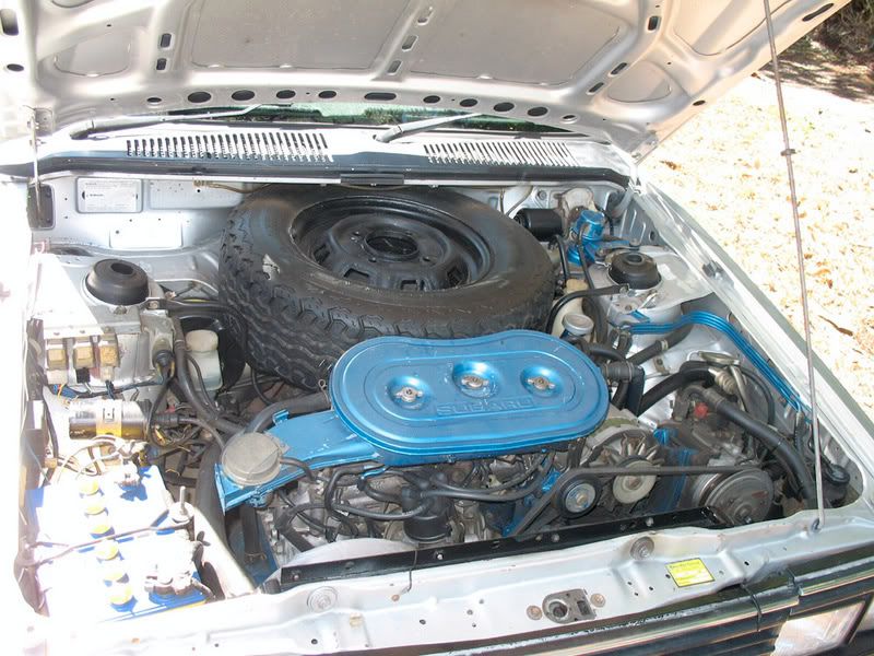

Post by Bantum » Fri Jan 11, 2013 1:22 am
I can't quite make out the type of coil in this ... must be a resistor type ?
But notice the dizzy + leads have been installed incorrect ( before I got it ) - I had to rotoate it 180 deg as the firing order was back to front - it still ran ok though ... ;)
So yeah, best to check you've got it installed correctly ... :)
