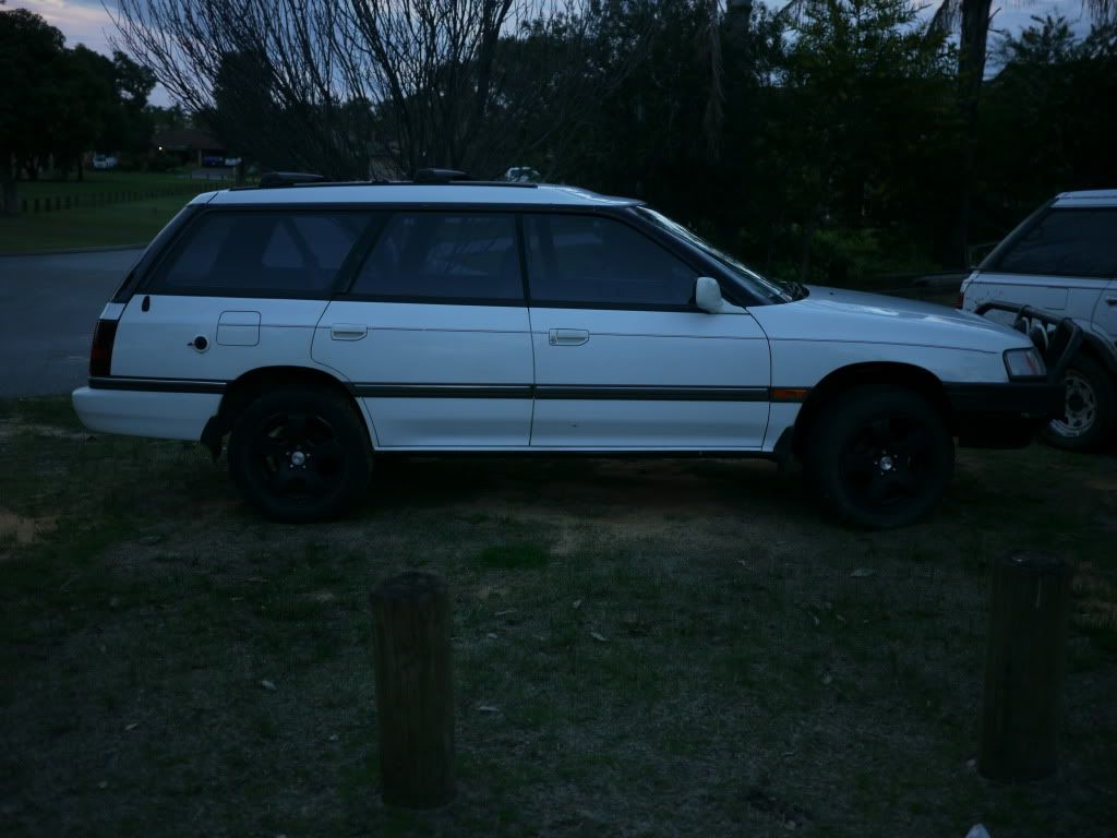

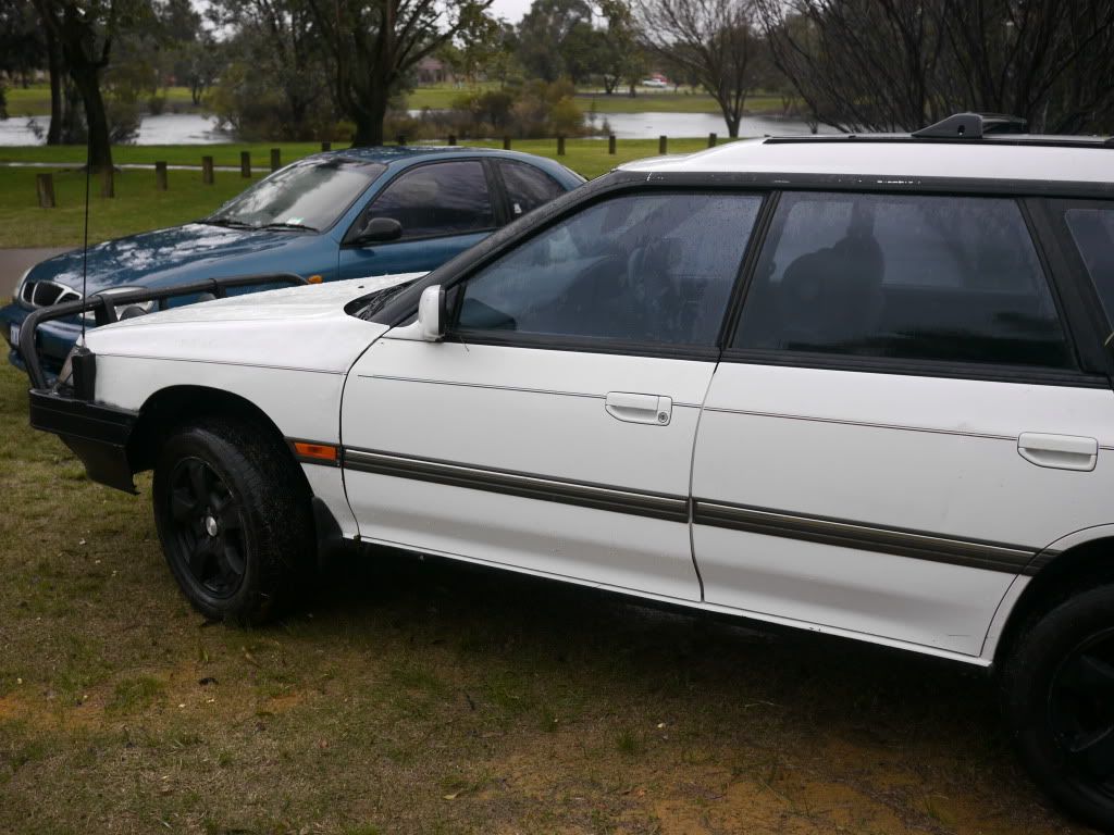

just thought i'd chuck some photos up of chloe my liberty... it was getting on in the evening so not the best pictures..
it's 1990 gen 1 gx wagon with gen 2 outback stuts and raised hd king springs..
planning on changing the engine at the end of the year in uni break to a ez30 or ej205... or 207 if funds permit... also want to put an lsd in the back and get some to rebuild the gearbox with an l-series low range..also a further 2" body lift later down the track as stubaru's l-series still has an inch of height on the liberty nd i just cant have that..

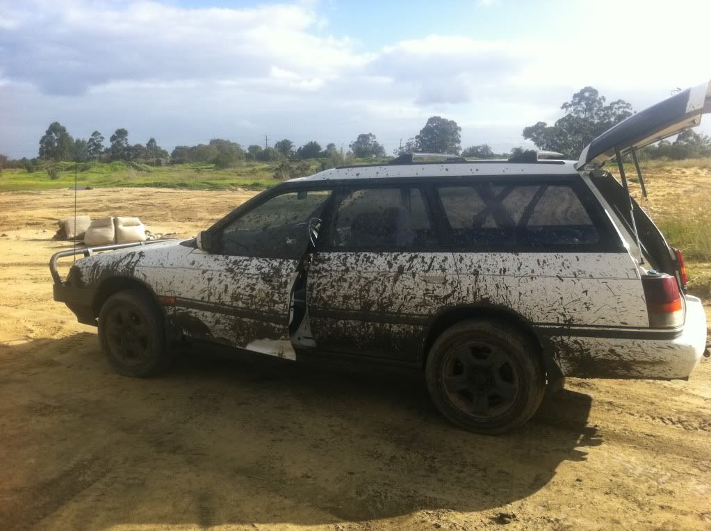

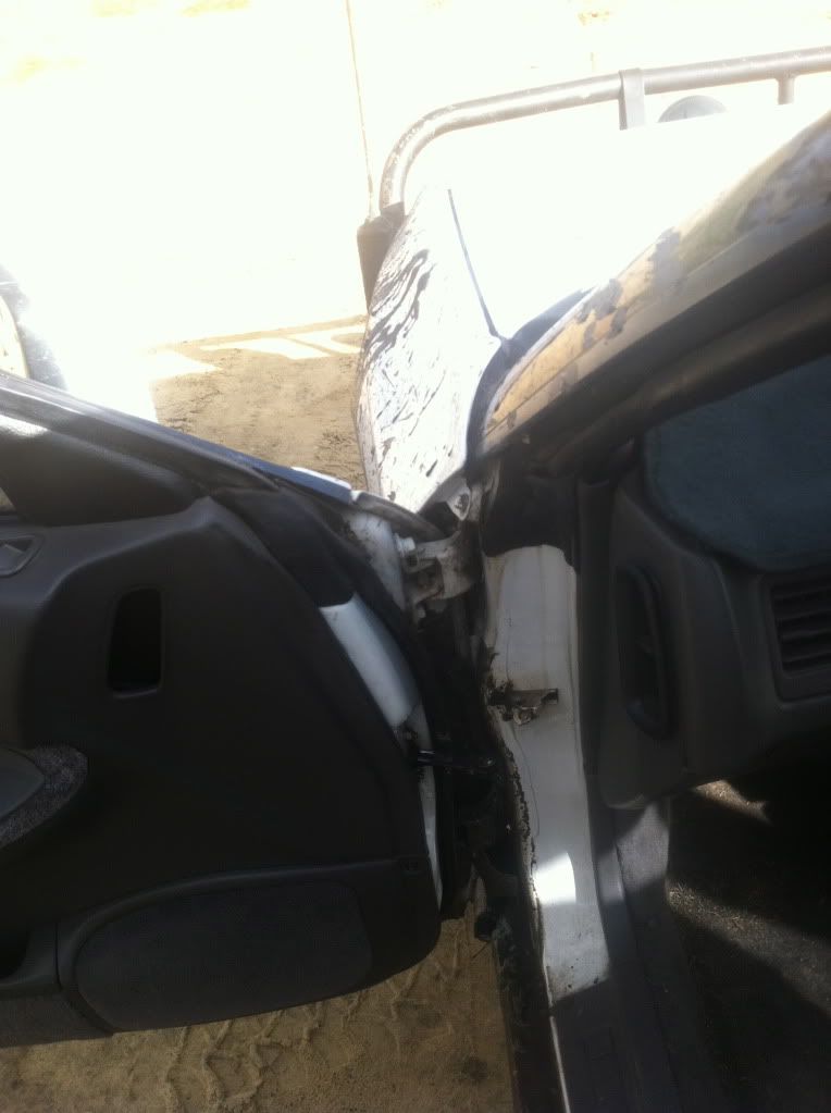

so took her for a spin and after getting nic to give me a bit of a push out of some really soft sand... the door wasn't closed properly and swung out and found itself being wedged back by a close tree.... also found out i have a real problem with my clutch as it just refused to grip in the sand just revving out and smoking quite badly reminiscent of bob marley in recording..

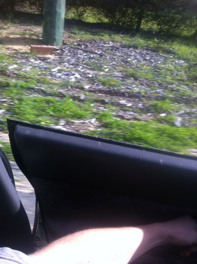

here are some pictures of the damage.. anyone got a front left door.. hinges and front quarter panel lying around... guy?
yes the second one is of nic holding the door closed while taking the backstreets home avoid the FIVE[OH}

Post by TOONGA » Tue Aug 09, 2011 8:40 pm
thats not as bad as it looks :)
take the door off and leave the hinges on
use a soft face mallet and extreme force to push the hinges back into place.
no rubber mallet a wooden block (jarrah is good) and an FBH will do the job.
try to reshape the pillar and quarter panel as well
put the door back on and align it and you will find all you need to replace is the door stop that broke when the door met with the tree.

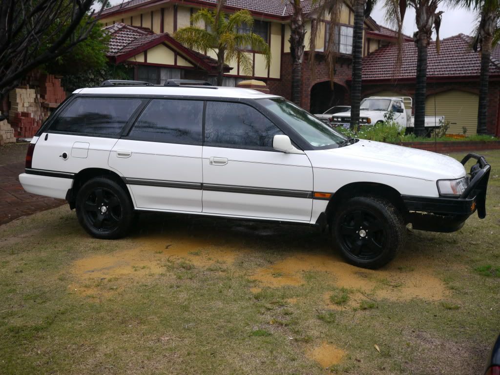

theres the new door doesnt look to bad bit hard to get the window to go up but im sure the rubber will adjust
and theres a picture of her in the daylight
