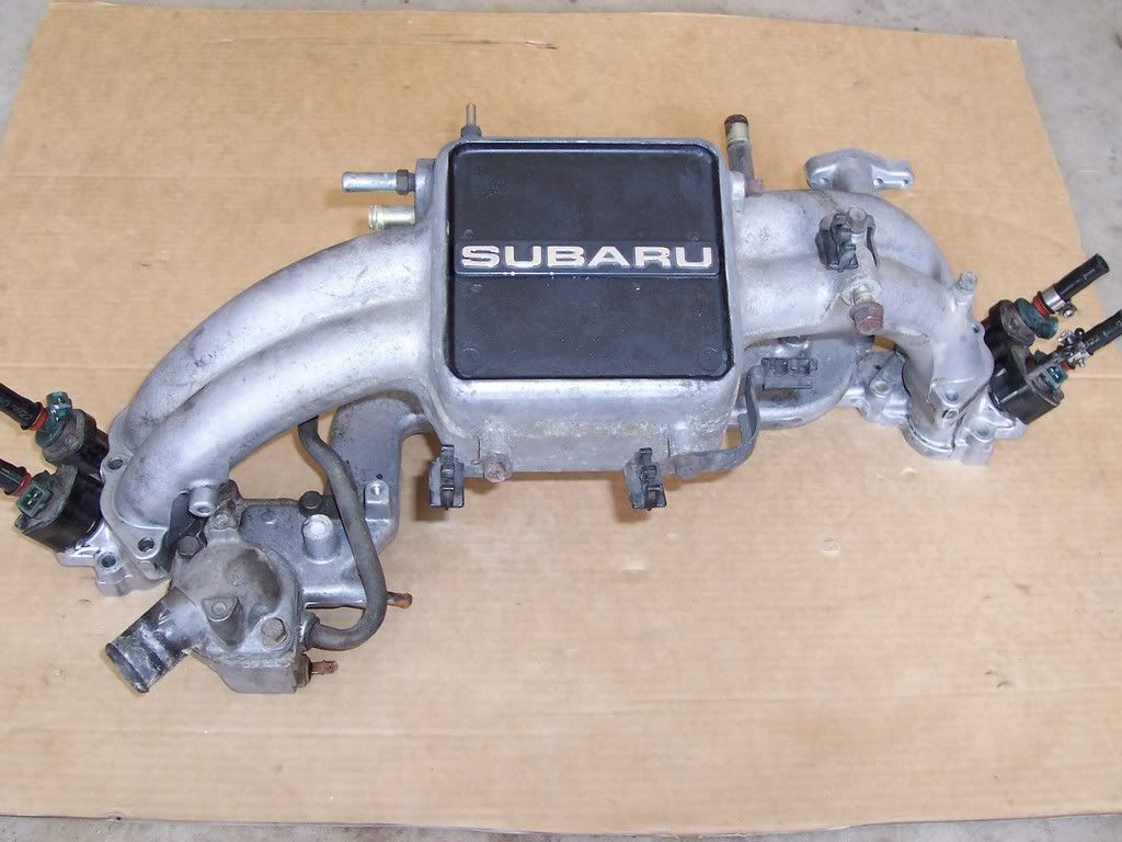

You could always fit an intake like this and mount a side draft SU carby or similar
(thanks to nncoolg for the images)

That looks interesting and with the right mods it could be done. What is that intake of if you dont mind me asking (obviously Subaru but what model, engine size etc.)? It appears to have 2 runners on each side (4 all up) but I could be wrong it may be a single runner judging by how the runners appear to terminate into one flange on the ends (Im relatively new to Subarus so forgive me if Im wrong). I like the sidedraught carby idea and was playing with it as i have contemplated on ways to make up a custom inlet manifold for the EA series.
I would rebuild the engine before making a custom manifold and thought the EA81 would be a better engine to use. That way I can keep the car running while I put together a reconditoned and modestly modified engine then swap it over with minimal problems and distruption to having the vehicle taken off the road for long periods of time (drop it in over a weekend).
I like the EJ idea but the time and money needed for a proper upgrade is prohibitive for me at the moment. I much prefer to take my time and do up a EA81 slowly but good and thorough then drop it straight in. Im not really looking for serious performance just a little better than standard and do most of it myself except for the machining and valves etc. of course. I like making things and thought the inlet would be great project considering it could be made with nice long runners designed to house the carby where the spare wheel lives. Besides it shouldnt be difficult to improve on the original with all the available room under the bonnet when the spare is removed.
The manifold above is interesting and gives more food for thought, perhaps extending the runners and having it up where the spare wheel used to live could be a option. Let me know what its of so I can go see and measure one for myself.

The manifold above with extended runners angling back upto the spare wheel well has also got me thinking.

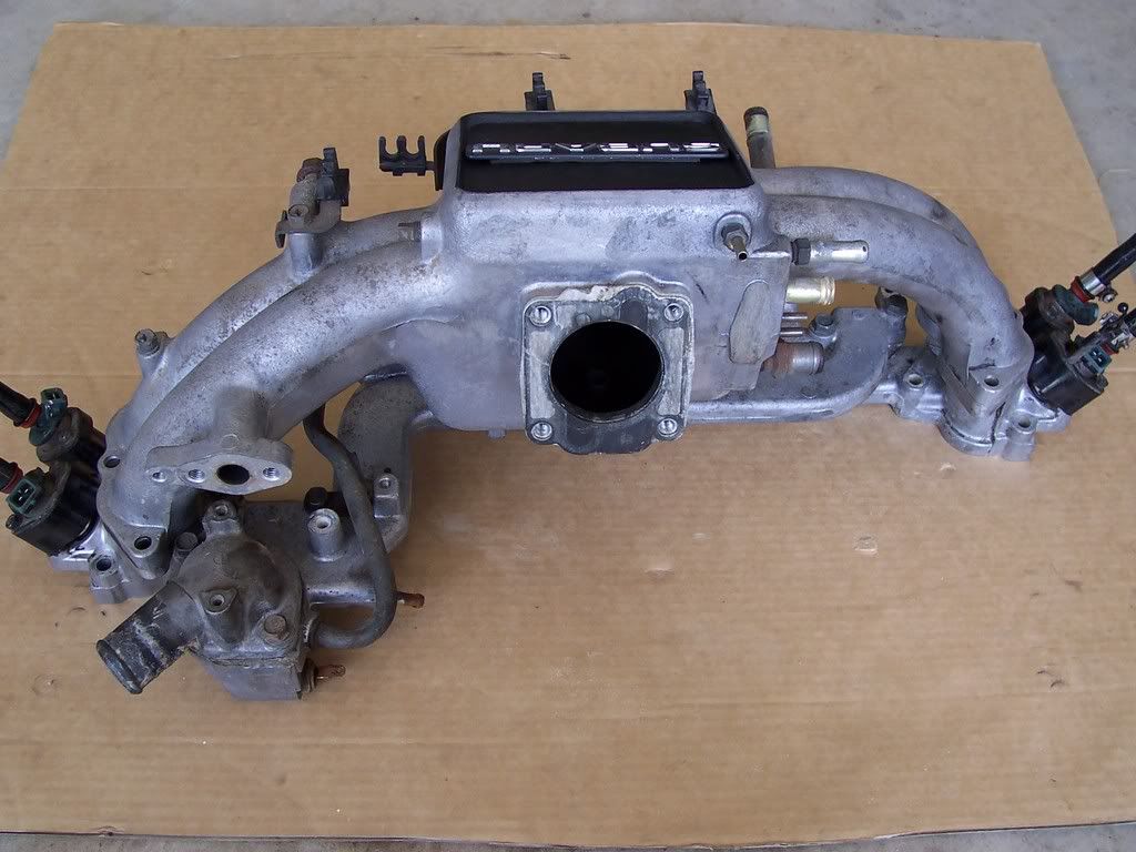

the above is a highrise intake off an EA82 MPFI or Turbo engine out of a my88 on Vortex. The 2 port heads from the EA82 will not work on the EA81, but you can get very nice 4 port heads and EFI intakes for the EA81 from a mob called SUB4, definatley worth getting, almost worth downgrading from an EA82 to an EA81 to use them!

nncoolg wrote:the above is a highrise intake off an EA82 MPFI or Turbo engine out of a my88 on Vortex. The 2 port heads from the EA82 will not work on the EA81, but you can get very nice 4 port heads and EFI intakes for the EA81 from a mob called SUB4, definatley worth getting, almost worth downgrading from an EA82 to an EA81 to use them!
I have looked these up, but Im scared to ask for a price. I will eventually muster up the courage though.
