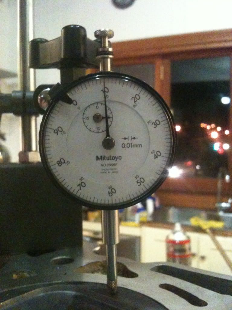

0.10 mm under deck hight, exactly where i want it!

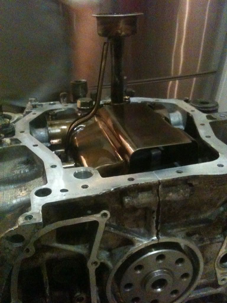

Baffle and Pickup

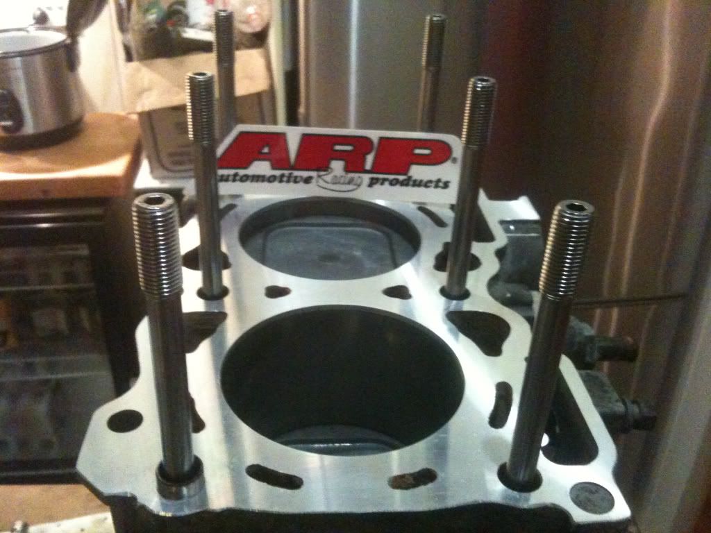

ARP product placements

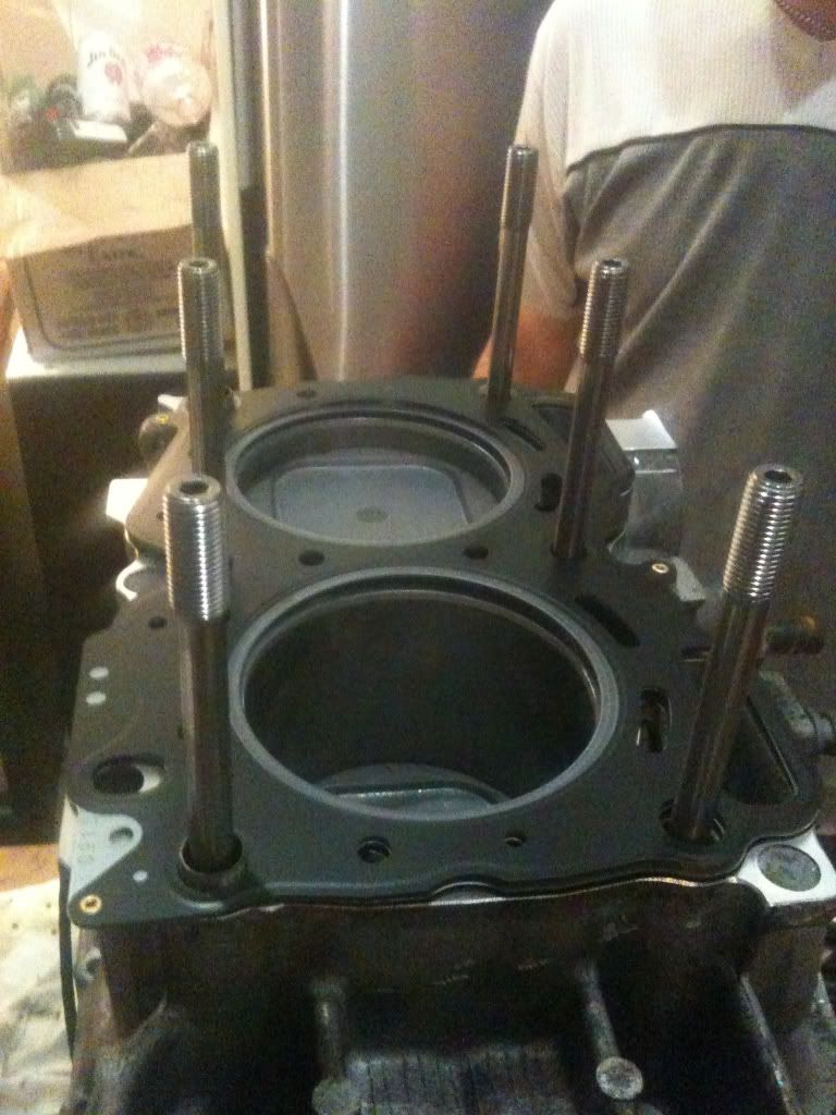

STi Multi Layer Steel head gasket
