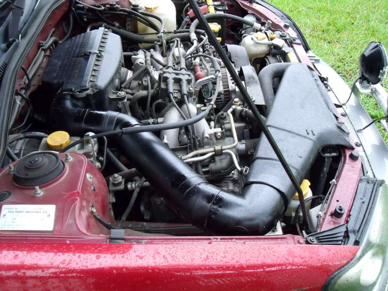

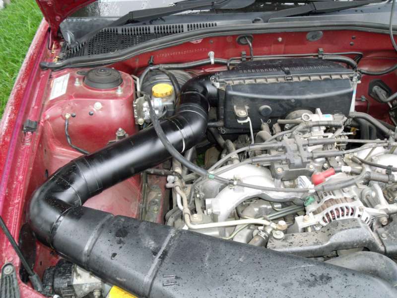

Anyway, i got bored and got thinking about the tiny size of the intake on my Outback, so i went to the hardware and bought two 90, one 45 and one 22 degree 90mm stormwater bends.
I got a 90mm holesaw and cut a bigger hole in my airbox, and then used the bends to connect it to the over radiator intake funnel.
It isnt finished yet, im gonna drive it for a week and see how it goes, it needs a support bracket and its kinda noisy at low revs
(sounds awesome above 4000rpm) so im thinking of grafting the resonator back on.
Pics
Not bad for about $17 in materials
