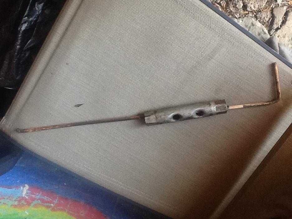

Here is what I ended up using:
[ATTACH]3830[/ATTACH]
Ground a little hook into the end and then just slid that metal piece for all my worth.
Thanks for all the info guys, wouldn't have got it done otherwise...especially without Ron's help.
They were stuck in there pretty good but they did all come out. Very satisfying.

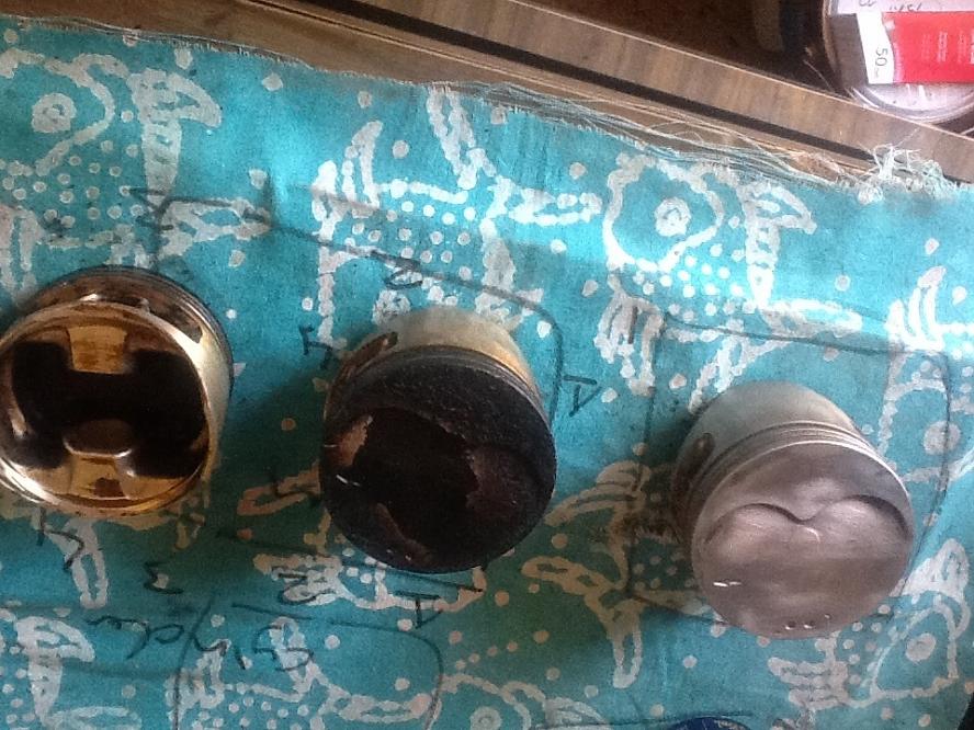

I have a couple of questions though. I started the clean up the piston heads with a soft wire brush attachment on a drill. I did one and then thought I should first just ask to see of this is okay to use this method?
[ATTACH]3832[/ATTACH]
Also, some of you suggested changing out the main bearings once I split the block. Are these main bearing the front/rear and centre crankshaft bearings?
James
Post by steptoe » Sun Jan 20, 2013 9:37 pm
well, I used to use steel wool on the sides and wire brush on tops, and a broken ring (break one if you don't have one yet ) to clean out the ring grooves/lands etc.
What is with the pitting / fang marks?
You might wanna try my label method - zip ties
red for one , two for blue, three is green and four yellow - easy to remember , one & red same number of letters, two and blue rhyme in English, three and green both got double ee, yellow has most number of letters so it goes on four.
Reassemble ya just snip 'em off as you go :D

Those marks are on all the pistons. Says something you can't quite make out in the picture. A number and letter I think, can't quite remember.
