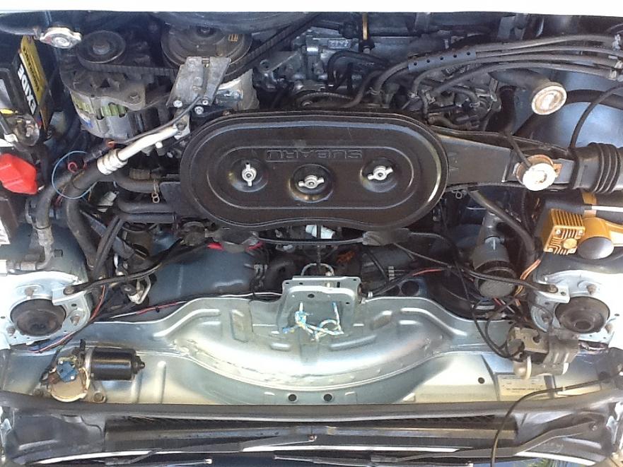

Post by jims » Mon Mar 18, 2013 6:34 pm
Well it's done. Almost.
The engine is in the car and running well. However, one problem I had during the install was that one of the studs on the head that the exhaust bolts onto stripped the thread. So while its all together, there is a lot of exhaust noise atm. I guess I will have to tap a new thread and replace the stud with something oversize. Then it will be done!
So the rebuild all in all:
new main bearings $16
new big end bearings $3
complete engine gasket and seal kit through the donk $105
deglazed the cylinders and installed new rings $41
resurfaced heads $100
new head gaskets (came in engine gasket kit)
valves lapped into their seats
new valve lifters $8each
timing belt kit about $100
spark plugs (alredy had new leads)
new engine ($60) and trans mounts ($50)
Plus things like engine oil, filterm brake fluid etc. Plus postage for some of this stuff.
I think that is most of it. While I had the engine out I also did some rust work and re-sprayed some areas in the engine bay.
Looking forward to getting the exhaust sorted so I can start driving it again!
Cheers, James

Posts: 12694
Post by El_Freddo » Tue Mar 19, 2013 5:21 pm
That's an interesting upside down photo of an EA82... it actually makes an EA82 interesting for a little bit! :p
