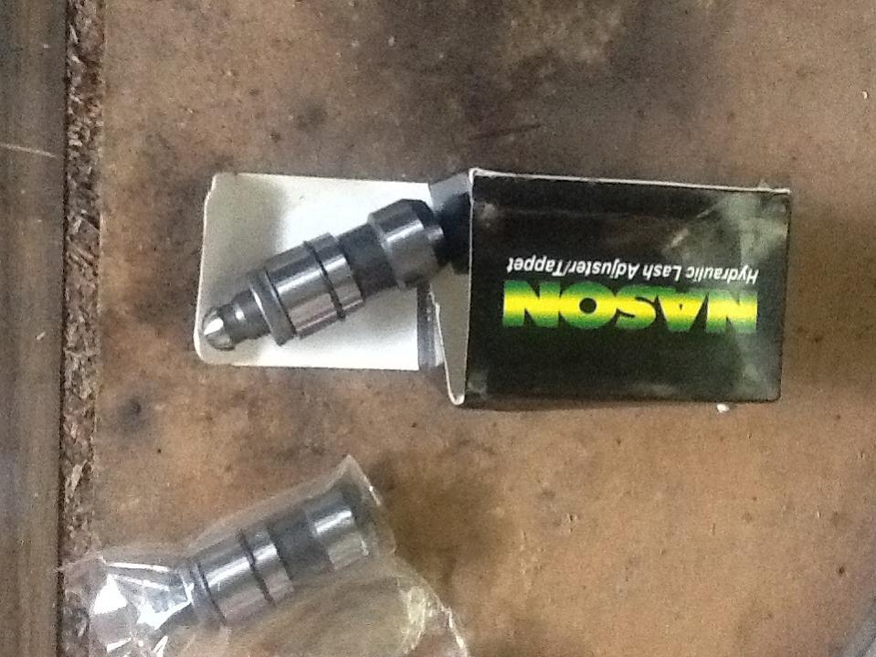

I got these hydraulic lifters today from Auto One. Nason brand, $8.60 each. [ATTACH]4004[/ATTACH]
Post by steptoe » Fri Mar 01, 2013 8:44 pm
That is so cheap, someone has found a stock pile of things and marked 'em down to sell perhaps...or makin' them in China and sharing the savings with us :)
Was there a NASON part number on the box ?
jims
Posts: 162
Location: Kalamunda
Post by jims » Fri Mar 01, 2013 11:04 pm
Amazing hey. There is one number on the box: RHT6400
Post by steptoe » Sat Mar 02, 2013 8:01 am
same number REPCo uses ! Which could imagine stands for Repco Hydraulic Tappet NNNN
eighteen dollars each retail there, was your eight bucks a misprint ?

Well, I got ripped off by REPCO as mine too were Nason (P/N RHT6400) at about $18.00 each.
I spent a couple of hours all up trying to prime the lifters in every possible position and eventually gave up. I tried an oil can forcing oil in, a syringe (spelling) and managed to get 2 of them fairly hard and ended up putting them into the engine as is. I also tried imersing them in oil but all to very little success.
I made a bit of noise on first start up but then went all quite.
