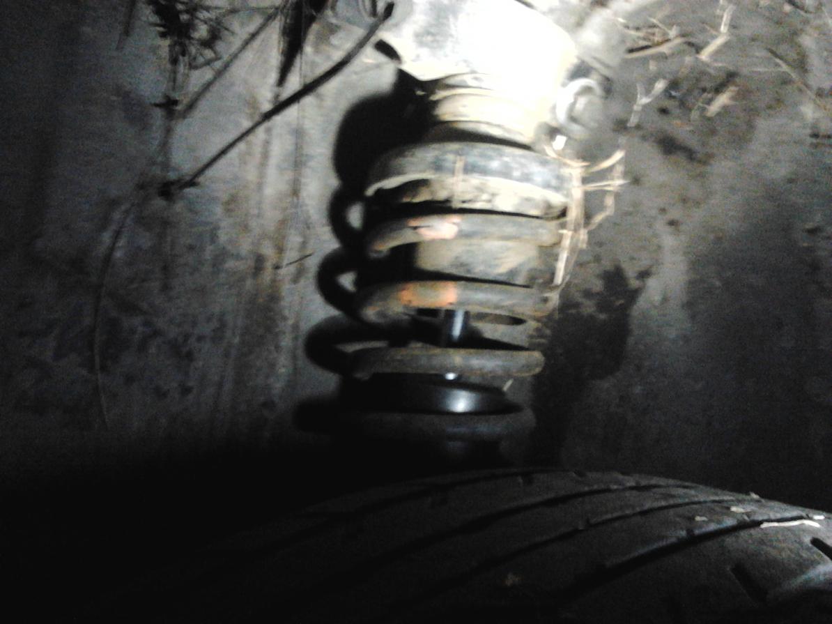

Upon closer inspection, the springs had a pink and orange daub of paint on them
Apologies for the crappy phone and torch photo
- 2012-06-03 22.05.44.jpg (95.42 KiB) Viewed 5013 times

Royale sedan is FWD sedan, so likely same as any FWD rear coils, sit same as RX rear springs but softer by 20 lbs ? is my guess....they were gonna be my first try but the RX springs turned up, one by one . I'm not saying if the RX rear springs on wagon struts will do the job, if your wagon struts specs match the pics I sent you - good bet anyway
