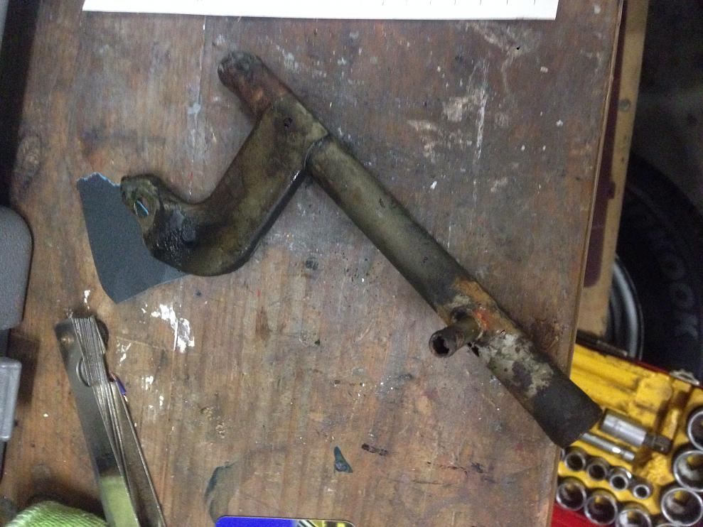

Hey guys,
After a water bypass pipe for an EA81 as I just discovered mine has two beautiful holes in it.
Anyone have one or know the best place to find one?
Andrew.

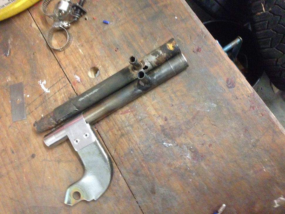

Post by Shorty_T » Tue Apr 22, 2014 11:55 am
I know it's not really the place for it but here's a bit of an update.
Ran through a few options using what I had lying around & just happened to have some stainless pipe that would work nicely.
Trimmed it up, put some notches in on the lathe, flaired the ends and silver soldered a smaller stainless pipe for the breather. I cut the bracket off the old pipe & riveted it onto the new one with a small bit of sheet.
Went away for the weekend and it performed flawlessly... Until on the way home
I noticed the temp creeping up, turned out another metal pipe nearby has a pinhole leak in it. Managed to fix it with some duct tape & zip ties to get it home :p
It never ends...
