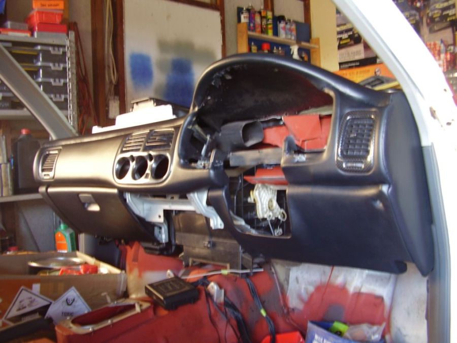

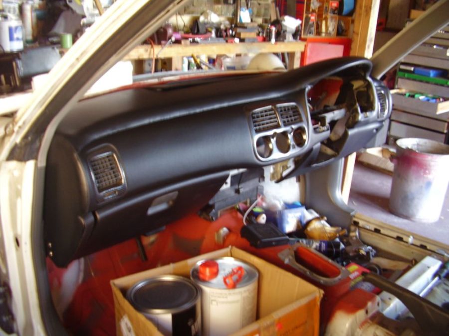

Post by 85wrx » Sun Sep 21, 2008 7:05 pm
Here is the latest pictures of the completed dash pad recovered and temp fitted. Not much has changed. Just completing alot of the little things that will tie the whole project together when it is done.
Engine is removed ready to tidy up then paint. Aiming to have the engine bay painted, engine and gearbox fitted with all the wiring sorted by then begining of next year. That gives me all next year to complete the body and have it on the road by dec 2009.
Enjoy

85wrx

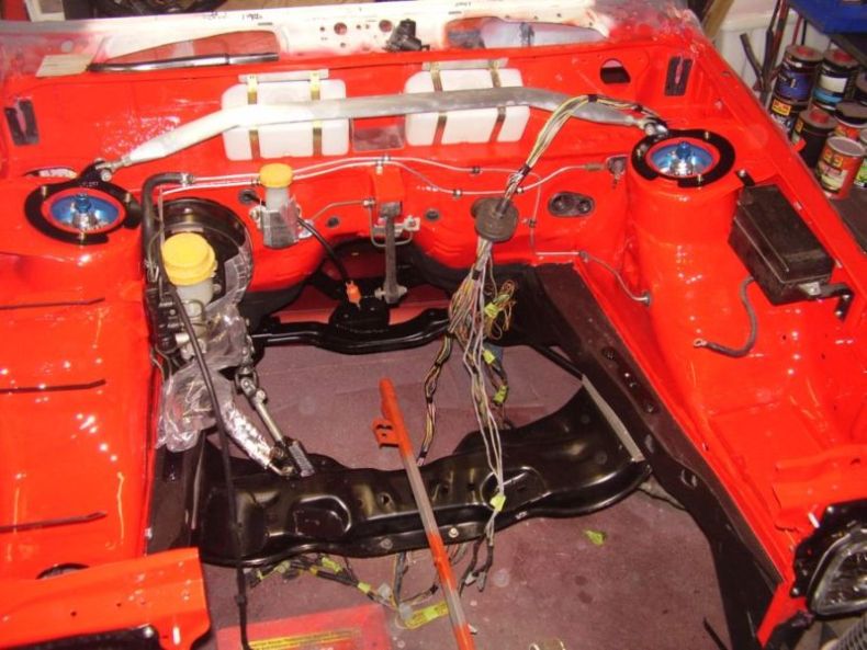

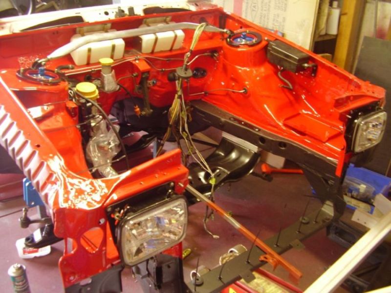

Post by 85wrx » Sun Nov 02, 2008 6:15 pm
Started the painting of the engine bay and assembly of some of the components. Today I fibreglassed a copy of a series 1 scoop to the bonnet. All the scoop ducting matches up perfect and will be removable. This is thanks to stainless ducting from zerosports. This will be it for a month off to work up north. Still aiming to get the engine in for good by christmas. This depends on the amount of work with the loom.

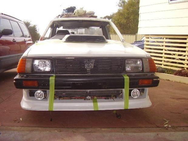

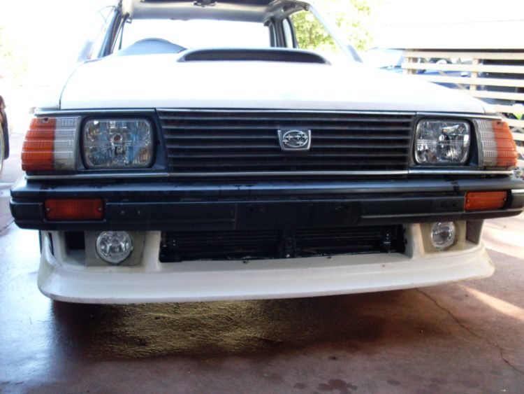

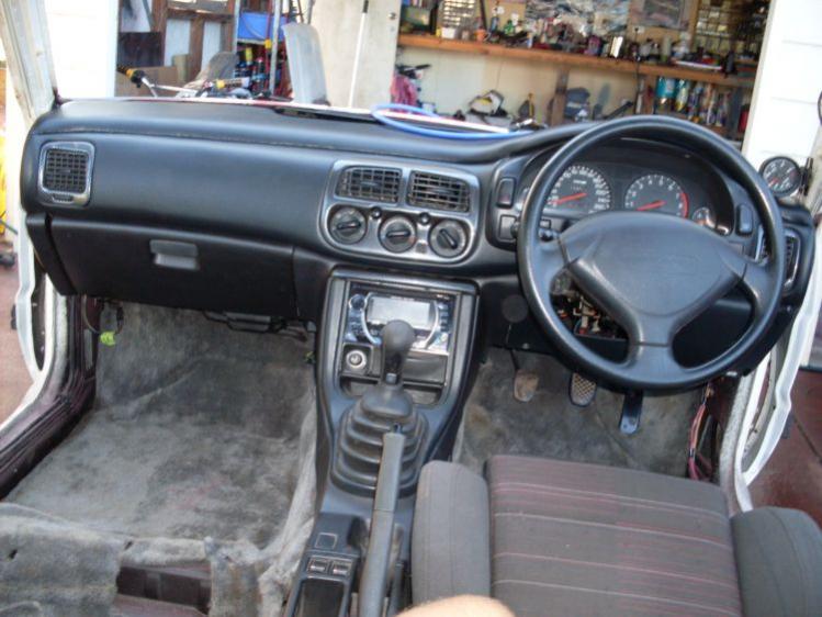

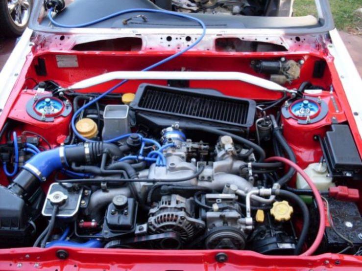

Post by 85wrx » Fri Dec 26, 2008 6:36 pm
As promised. Here are the latest pictures of the car as it stands.
front new.JPG (88.03 KiB) Viewed 6770 times
dash new.jpg (63.25 KiB) Viewed 6768 times
chubby37
Posts: 1058
Post by chubby37 » Fri Dec 26, 2008 7:12 pm
nice...looks like its all ment to be there and thats the secret to a great conversion.....top effort
lovey80
Posts: 218
Joined: Sat Jun 09, 2007 4:54 pm
Post by lovey80 » Fri Dec 26, 2008 11:47 pm
Really good effort there mate? How long do you thin until it is finished. That dash looks really good was there a big problem getting it to fit? How long was the install?
