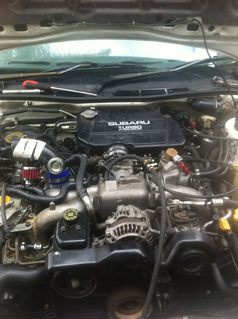

got stuck into things today got it all pretty much in place bar the radiator as i couldnt get it to sit down on her engine mounts properly and gave up for the evening but heres what the engine bay now looks like.. did a quick compression test which read 150psi which was good.. but the wiring looks likes its going to be fun to separate what i need from the old loom from the un-needed stuff..

big thanks to dave shes all running now with a few bugs to sort out, the temperature sender seems to be shot and there is no way im changing it looking at its position so have ordered a after market one off ebay and a power steering leak leak which ill sort out in the morning but my biggest problem is still with boost, i'm still only getting about 5 pounds which i assume is waste pressure.. i had it in the car the engine was previous in but i thought i would have sorted it out with the re-installation of the factor boost solenoid etc which was missing but seems not... ive done my best to make sure there's no leaks and everything is connected up right but as its happened in both cars id assume there is an underlying issue..anyone got any suggestions as to what would cause it?

Have you inspected the turbo? There could be cracks around the waste gate, this will lead to bleed air that will be taking away from your exhaust gases to spin the turbine and thus you lose out on some boost.woody.t wrote:id assume there is an underlying issue..anyone got any suggestions as to what would cause it?

i've not got a restrictor pill, i was under the impression not having it would cause excess boost and boost cut but im hopefully getting one tomorrow in any event .... the turbo is fine i did have a decent look at it but i think the waste gate may not be functioning properly so i'll take it to a mechanic friend to confirm

playing around with her today i disconnected the waste gate actuator vacuum line and she boost up to about 14psi before i took the foot off ... so cactus boost controller? should i just by-pass it with a manual bleed valve?

yes.woody.t wrote:playing around with her today i disconnected the waste gate actuator vacuum line and she boost up to about 14psi before i took the foot off ... so cactus boost controller? should i just by-pass it with a manual bleed valve?
the guys that bought it after me may have stuffed something. I was running a manual bleed valve at 16-18psi just before she hits boost cut.
