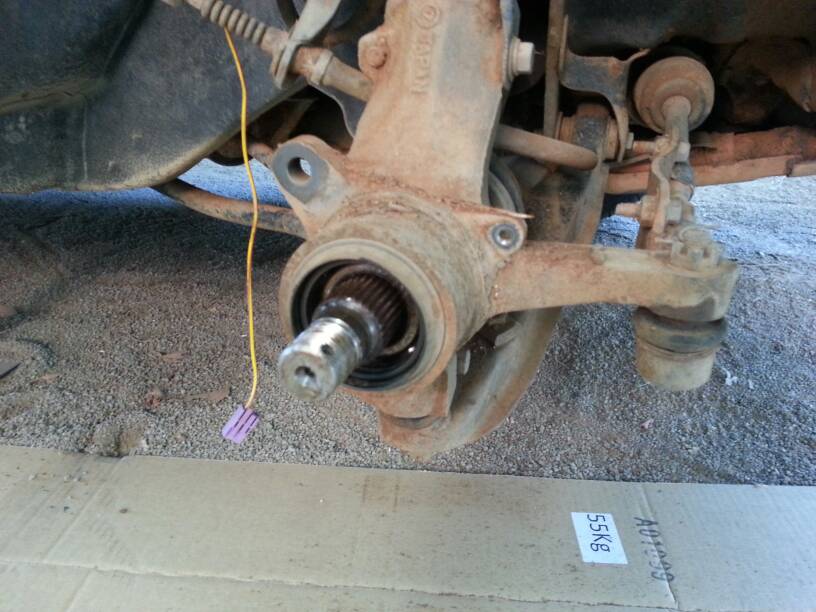

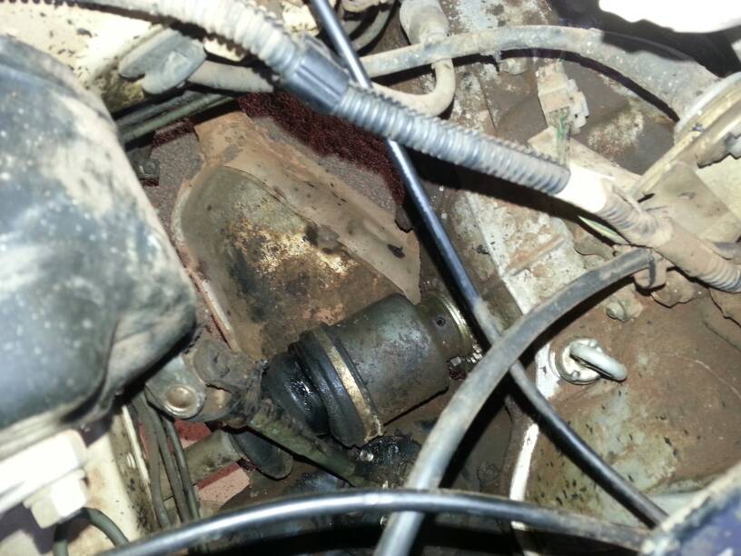

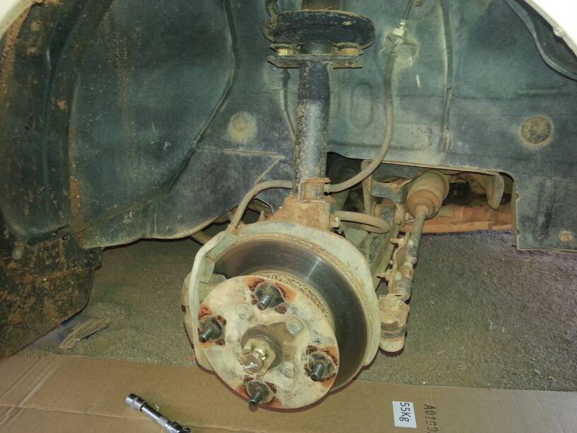

Changed the cv shaft yesterday. It wasn't too bad but i still managed to fit some swearing in.
[ATTACH]4046[/ATTACH]
First up loosen your wheel nuts and the pop the split pin out of the crown nut...then loosen it. It's 36mm and mine was bloody tight, i nearly lifted the ute off the ground.
Then jack it up and take the wheel off.
[ATTACH]4048[/ATTACH]
Undo the brake caliper bolts and tie the brakes up to the spring.
[ATTACH]4049[/ATTACH]
Slide the hub off. Might take some jiggling. Then take the brake dust cover off.
[ATTACH]4050[/ATTACH]
Get a 6mm drift or punch and knock the roll pin out of the cv at the gearbox.
Then with a rubber mallet give the shaft a hit and knock it free of the bearings.
I didn't have much luck with the hub ball joint so i just popped the tie rod end ball joint out. I undid the two bolts in the sway bar looking thing and then unbolted the whole arm from the body mount.
This gave me room to pull the hub out and off the shaft. Then i yanked the shaft off of the ute and chucked it.
Putting back together was just a reverse process, just remember to gease bolts and the new axle where it slides through the hub, to help stop rust, dirt etc stuffing the threads.
Unfortunately i didn't take many pics of the reassembly because i was hurrying and geasy haha.
Cheers, Stretch.

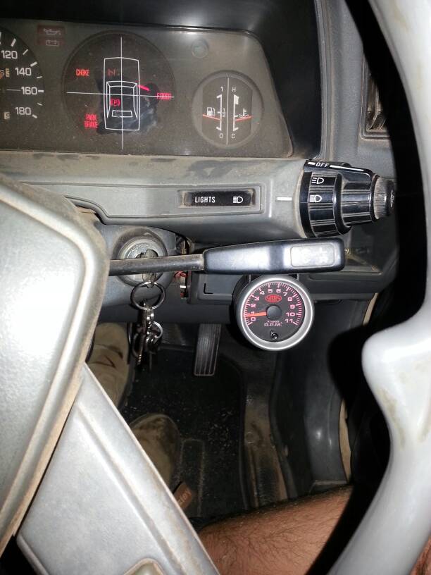

Cleaned and painted the hubs silver and cleaned a heap of mud out of the wheel arches and the rims. Got the shudder out of it!
I also ran a couple of 6mm earths off the battery. My lights dim alot when revs are low so i thought better earths might be a good start.
And a pic of the tacho i installed a few weeks back.
[ATTACH]4060[/ATTACH]
Good to see how many revs it's doing.
Might get some pics of the wiring incase anyone wants to see how they hook up.
Cheers, Stretch.
