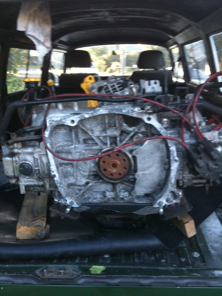

I know the car certainly goes hard and sounds great. here are some photos of ej18

Post by vdubrod » Wed Feb 17, 2010 8:48 pm
Suparoo
I put some photos in my album of ej18 SPI engine
Post by Gannon » Wed Feb 17, 2010 9:11 pm
Where is your album?

a question about the distributor as it looks like the stand alone unit does it have a plug with 3 or 4 pins or does it have 2 wires coming out of it ?
