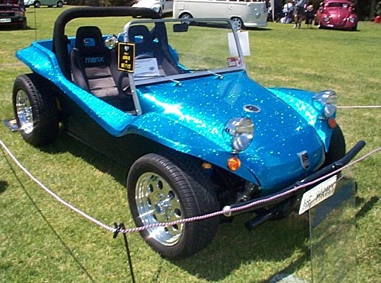

SCOOBIDOO wrote:I am not sure what they would be worth to buy nowdays..though i do know they are extremely well suited with the wolf 3d ecu... i am currently enjoying 155 hp in a 550 kg vehicle.....what would you consider to be fair pricing on this item?..cheers
550kg? Dude what car is this?

550 kg sounds like a VW beetle. I have spoken to a guy years ago that had a beetle with EA81 in it - with two tiny turbos and twin carbs, said to keep up with WRX's except for corners !!

beetles are 850kg
Post by SCOOBIDOO » Mon May 07, 2007 7:18 pm
AndrewT wrote:550kg? Dude what car is this?
only an sti will lose this thing..12 psi jdm on optimax eqivelent...i went lighter and more power rather than trying to get a 1000kg car to go hard.....bikes under 500cc try to keep up...

Cool little buggy. Knew a guy that put his smowmobile Porsche motor in one of these, alittle backfire turned it into a flame thrower !!
