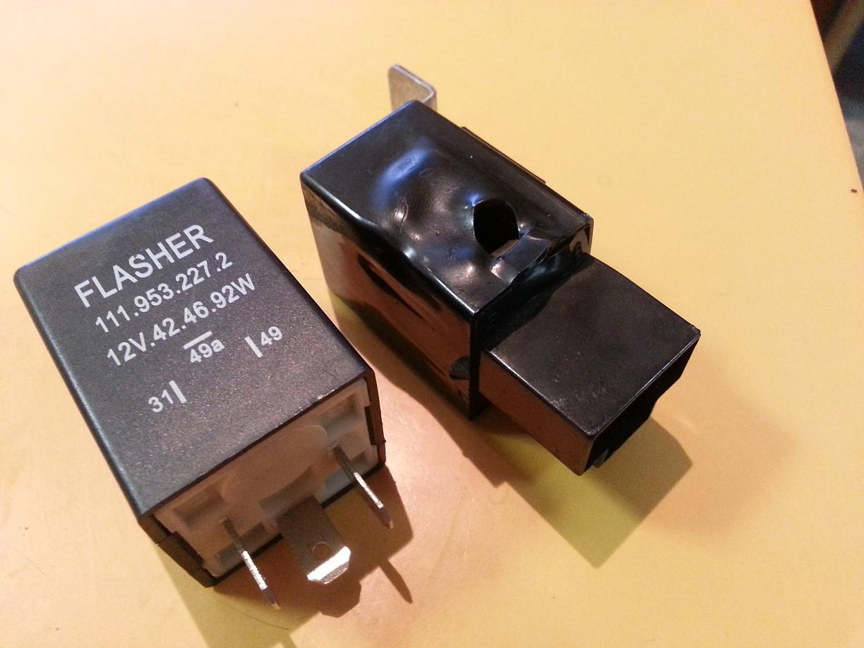

so eventually got around to changing the relay that i got from the auto store, the guy said that it would do the same thing as the original. I replaced the relay and... still nor working, checked all the fuses and globes again all good, so could it maybe be the switches the hazard switch and the indicator lever???
Heres the nice burnt hole in the old flicker unit and the new one I got given...

Post by Gannon » Sun Mar 03, 2013 10:25 pm
Ya know there are 2 types of flasher can, it relates to the pin polarity
Dann
Posts: 232
Post by Dann » Sun Mar 03, 2013 11:55 pm
oh really? can you please explain?? how can i tell???
Thank you for any info
