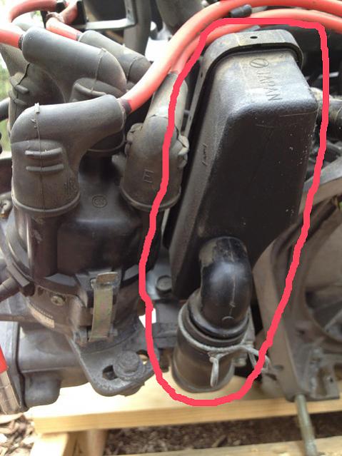

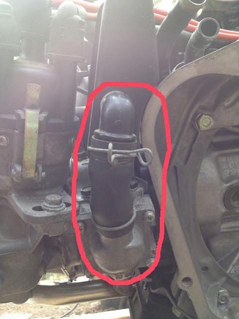

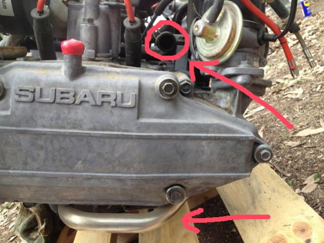

I am replacing an EA82 motor in a Kombi, and the new one has what the Gregorys manual indicates as an Air Injection Valve I think.
The old motor did not have this unit. Where should the outlet, (plastic/rubber pipe) go?
Attached pictures show it is next to distributor and the outlet(?) is circled.
A metal pipe leading to the exhaust comes from it too (as arrowed).
Any help or info would be much appreciated.
Post by Gannon » Sun May 05, 2013 3:39 pm
Air injection valve draws fresh air into the exhaust to help the catalytic converter burn up un-burnt fuel and reduce NOx emissions
In your case, just block off the unused pipe
