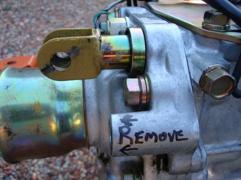

i then just bolted everything back up but i found that the gearbox was touching the body of the car which was making a shocking sound. So it needed to be moved down a little. but i drove around a while like that anyway and was all good apart from the knocking. i have read somewhere since then that there is a little bung or lug or whatever u wanna call it sitting on top of the gearbox that should be cut of before fitting as this is what hits the body of the car. but instead of pulling the box out and cutting that of i just pulled the crossmember out, cut the ends of and re welded them back on so that the middle bit sits lower. cleaned it up to make it look factory an its all good. even passed a rwc.
so if i was to do this again i would cut the piece of the gearbox to make it fit better and i would also pay a bit more attention at fileing the holes out in the mounts. file the mounts so that the gearbox sits as low was possible. i think if i had of done that then the box would have sat in pretty well.

just been trying to imageshack a pick of the threaded boss that needs removal. No Go. Giles has shot if he can fit it in here. Essentially it is a useles threaded boss at the top right rear of the box at the shifter end.

Post by 1111giles » Thu Jul 15, 2010 6:54 am
Hey folks as Jonno says here is the image of the useless lug.
Giles

Post by steptoe » Thu Jul 15, 2010 11:53 am
Thanks for picking that up Mr Giles, imageshack did not give me any address to copy and paste. Tried twice, gave up.

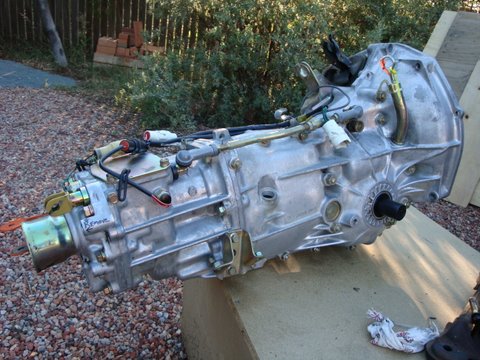

Post by spike » Thu Jul 15, 2010 9:16 pm
thats awefully clean lol
Post by steptoe » Thu Jul 15, 2010 9:32 pm
took an awful lot of work to get 20 years of crud off it too, degreaser, wire brush, pressure wash, wax and grease remover - I can be anal at times :)
