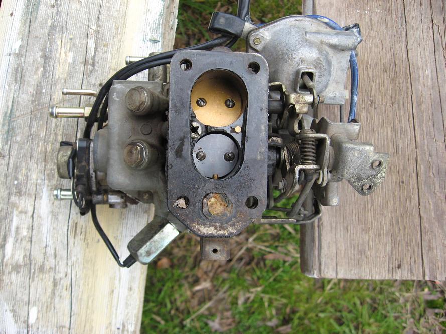

Post by olddog642 » Sat Jul 10, 2010 2:55 pm
Well I bit the bullet made some drawings took a few pics then got to work.
The carbie is off and yes it is a DCP306-26 now all I have to do is source a gasket and rebuild kit, strip it down clean reassemble then replace lol simple mmm we will see.
