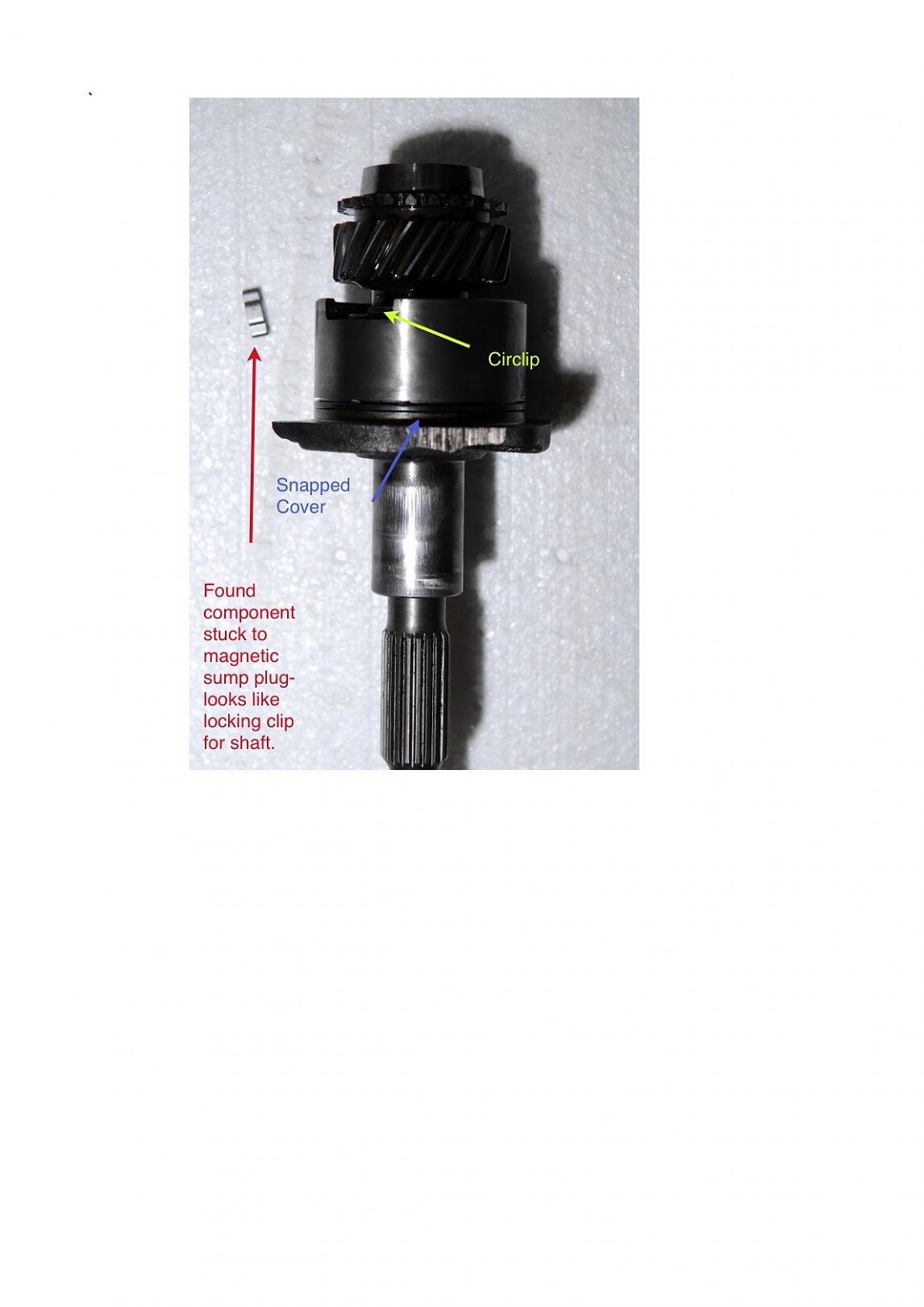

Pix of Input Shaft
Hi Mat / Everybody
I have started to split the GB and the input shaft came out easily but I cannot split the box I have tried everything but it is stuck tight at the bottom of the box near the extension housing.It is close to splitting but i cant find what is holding it together. I am restoring a Brumby and have had years of repairing cars- changing clutches , brakes ,shocks, electrical, body work,carbies but this is the first time on opening a box and am finding this one difficult. But I am determined to recon the box. Is there are any Subie Yoda's out there who can enlighten this GB newbie as I do not want to apply the Force (hammers) to this box as I already broke the cover and do not want to repeat that brilliant trick again.
Really enjoying restoring the Brumby.
Thanks for any help
Phil
Thanks for any help
Phil
- Imput Shaft.jpg (85.08 KiB) Viewed 1808 times
