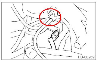

Post by kj0 » Fri Jul 09, 2010 12:20 pm
Hmm.. There's a few option I found and Wonder about. The Manifold and line are looking a little harder to get at then I've experiences on Alloytechs and Nissan Engines.
Here are a couple I've found.
The Fuel Regulator.
http://img697.imageshack.us/i/option1l.jpg/
Under the TB on the right under the valve
http://img34.imageshack.us/i/optiontwo.jpg/
On top of the TB
http://img805.imageshack.us/i/option3.jpg/
Those are the ones I found.
Couldn't find the one you were talking about though.

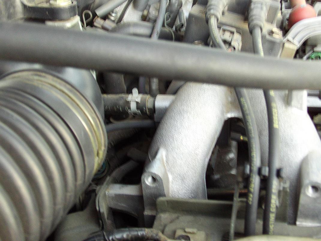

Post by Gannon » Fri Jul 09, 2010 3:27 pm
Option 1 is not the fuel pressure regulator
Option 2 is a coolant hose
Option 3 is ported vacuum so you will only see vacuum at partial throttle.
I'll have my car this afternoon after i drop off the work truck and i'll take a photo for you
Post by Gannon » Fri Jul 09, 2010 5:06 pm
Your best bet is to buy a T piece and put it in line with the fuel pressure regulator vacuum hose
It is the small pipe below the brake booster line.
kj0
