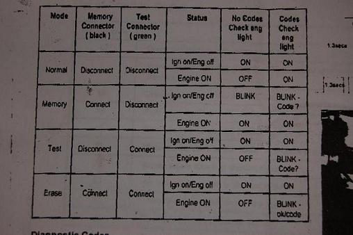

Have you tried just connecting the green plugs then turning the key to the on position? Sorry to ask if you have but from the way I read your thread it sounded like you hadn't.
What year is your EJ22? I had this code come up before and it was from the wrong resistance in the injectors but I doubt this is the problem because it sounds like you have been running this setup for awaile?
Sorry... I may have mislead you earlier, I just tryed getting the codes out of a Liberty today... Connect the green plugs and start the car, then let the engine run until you read the same code twice. Then turn the car off. The engine will run in Limp mode for that time but will not hurt it, fans should cycle on and off whilst it is in this mode. Once you have all the codes then make sure you disconnect the green plugs.
I thought that connect green plugs, shows current codes
Connect Green and Black, shows stored codes.
Reset the ECU, then see if it reappears

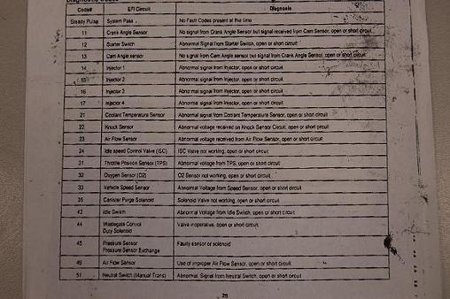

this might help...
I have full size if anyone wants a copy?
- Liberty Codes 2.jpg (67.34 KiB) Viewed 5171 times
- Liberty Codes 1.jpg (75.1 KiB) Viewed 5182 times

Not trying offend here but how did you get the code 47? 4 long and 7 quick flashes?
Ok... done some quick reasearch.... was your old lib an Auto??
Code 47 is NOT fuel injectors. The fuel injector codes are 14,15,16 and 17.
Code 47 IS the Economy Switch Circuit which is found on Automatic Models only.
To fix this i assume you want the ecconomy mode switched off. There is a wire coming off the ECU that you need to give a 12v ignition feed. If you still belive code 47 is fuel injector related then ignore this. If you want me to tell you what wire you need to join to where then i can help.
