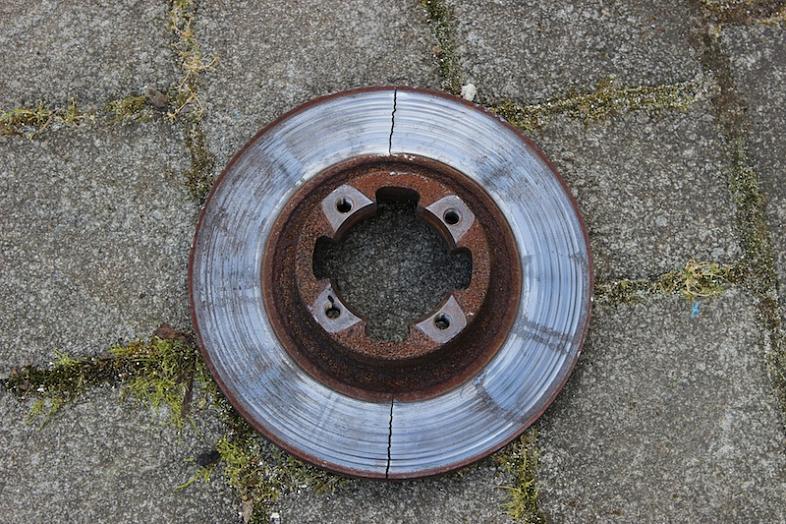

I'll take some tomorrow. It had been crazy wind and rain (like usual) the day before. The quick frost during the night made everything solid ice. When I was reversing out of the spot the following morning it didn't move for a second and then SNAP! broken disc.

I too am keen to see this broken disc. Part of me is thinking of ice that's in the vented part of the disc that's snapped it down the centre there, another part of me wonders if it's just the brake pads breaking the icy bond with the disc...

Here are a couple of photos.

Oooh crack just like that... ouch!
- Posts: 12708
Holy crap! That's awesome and bloody frustrating at the same time!NightHawk wrote:
I hope this was an extreme event - difference in heat from one side to the other during cool down due to the hand brake holding one side of the disc?
Never seen anything like it! I hope the swap over was an easy process
- 820695_10151492654644610_1516538323_o.jpg (116.82 KiB) Viewed 6392 times
What have you guys been using to screw in the brake cylinder? I used this multi-cube thing and it started to damage the metal. It has hardly any grip and the cylinder is so damn stiff. I had to replace the pads because they chipped after the break.

Wow.. those discs are knackered
2 things come to mind whilst looking at these pics...
1) Discs look very thin
2) Looks like the pads are very high metal compound
I would buy some good quality discs and softer pads. Soft pads means more brake dust and wear out quicker but cheaper buying pads than discs all the time.

Those discs do look close to minimum thickness !
when I look at the new ones I have to agree. Well it's a wake up call then to put new ones in
