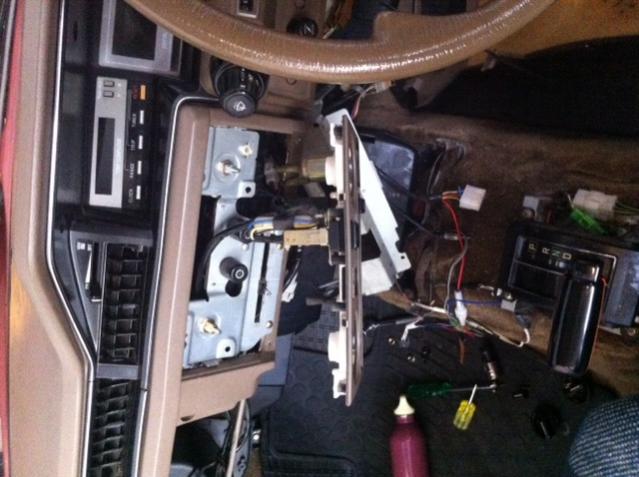

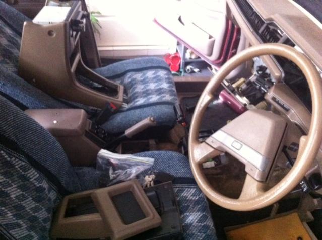

I went on the hunt for the fuse under the dash for the aircon.... just went in blind and this is all I could find... any idea what it is? and where the fuse normally is?
Drove through sydney at 1pm Saturday - so damn hot - that spurred my hunt for working air con.
[ATTACH]3717[/ATTACH]
[ATTACH]3718[/ATTACH]
[ATTACH]3719[/ATTACH]
I found it on the Aircon switch behind the climate control panel..

Thats not a fuse, its a diode to only allow current to flow in in one direction.
The end that has the white circle around it is the output.
The fuse is usually located near the battery.
