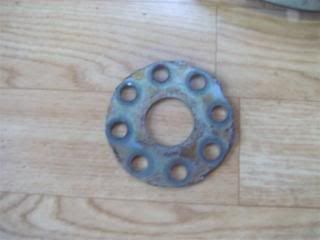

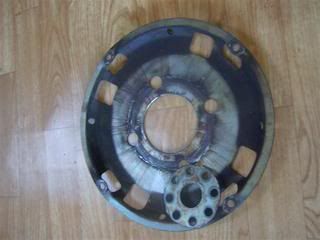

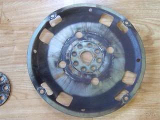

Post by stamp_licker » Fri Oct 03, 2008 4:27 pm
Heres the carnarge,well not all of it.
The tally
One broken flexplate
chewed out spigot
chewed out locater on the t/c.
Building a hardcore postie:D

Post by Suby Wan Kenobi » Fri Oct 03, 2008 5:06 pm
Is the spigot in the rear of the crank damaged?
how badly chewed is the centre locator?
Made a nice neat cut out of the flex plate

Post by vincentvega » Fri Oct 03, 2008 6:58 pm
fark thats impressive!
were the bolts all tight when you pulled the remains out?
