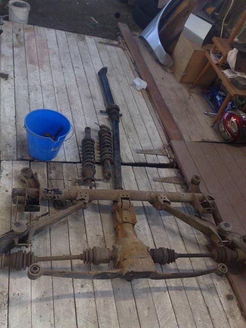

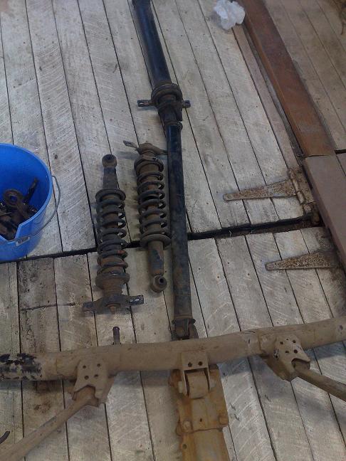

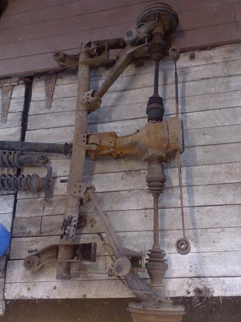

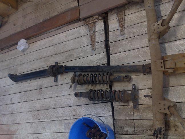

G'day,
I got my rear end today from a 1990 L series Wagon
Including diff, tailshaft and rear KYB suspension (not sure how flogged out yet though)
All this for $100 from the wreckers across the street, hoorah for the boss being connected :)
trying to attach pics :)

^ Nice - that rear end will do the job!
