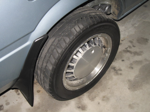

Could anyone tell me what wheels these are? sorry I don't have a closeup, since I don't know what they're called I couldn't google it :D Anyway Dad has these wheels on his L series at the moment (here in SA) and they stick ever so slightly outside the stock wheel arches. I can always tell because it looks a bit cooler than all the other L's :rolleyes:
But they don't rub and he's never had a problem with cops or when he gets his tyres changed they don't say anything...

Silverbullet wrote:Could anyone tell me what wheels these are? sorry I don't have a closeup, since I don't know what they're called I couldn't google it :D Anyway Dad has these wheels on his L series at the moment (here in SA) and they stick ever so slightly outside the stock wheel arches. I can always tell because it looks a bit cooler than all the other L's :rolleyes:
Silverbullet you probably should have started another thread with this question, however the wheels are made by Performance. Sorry I do not know the 'name' of the style but if you look closely at the painted black area where the wheel nuts go you will see 'Performance Wheels', or something like that.

sublime wrote:Silverbullet you probably should have started another thread with this question, however the wheels are made by Performance. Sorry I do not know the 'name' of the style but if you look closely at the painted black area where the wheel nuts go you will see 'Performance Wheels', or something like that.
Oh ok thanks! just thought I'd mention it here because these wheels are a bit wide on the L and I didn't have a better pic.

Silverbullet wrote:Oh ok thanks! just thought I'd mention it here because these wheels are a bit wide on the L and I didn't have a better pic.
Early Subarus had wheels with an offset more like a RWD wheel. With the L Series in '84 the offset was like a FWD rim.
My 1978 Wagon has Peugeot 505 15 inch rims and they fit within the guards perfectly. On an MY they would 'just' fit at the front and on a L they would stick out past the guards.
Gotta say I love the photo you posted! The side stripe suits the wheels to a 'T'.
