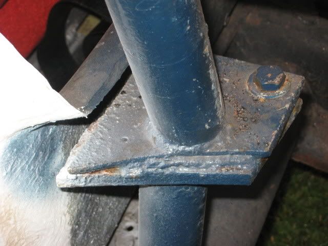

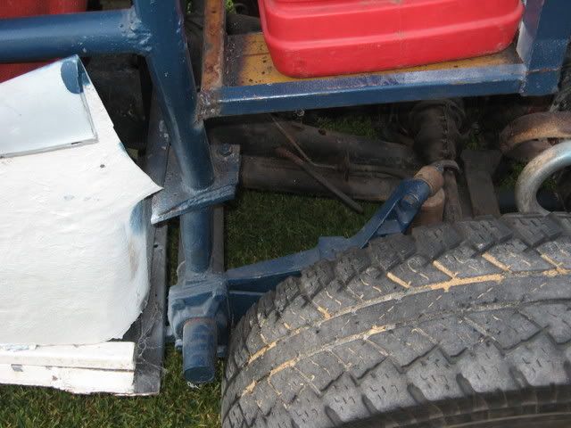

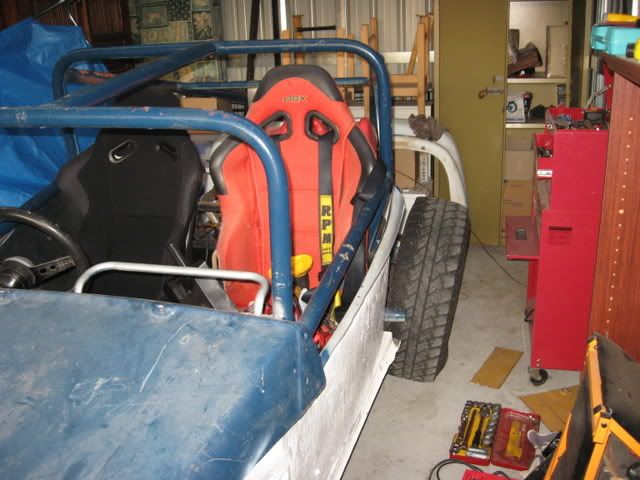

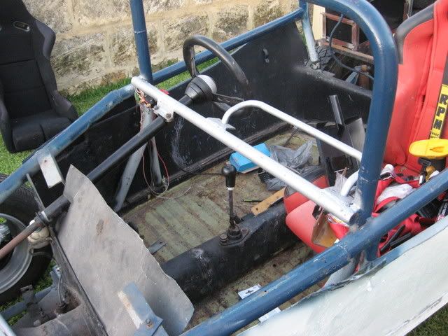

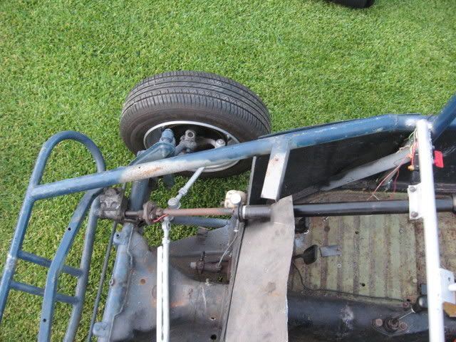

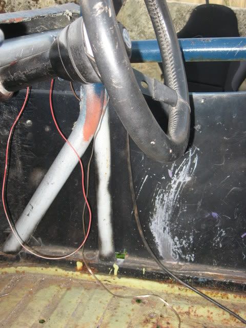

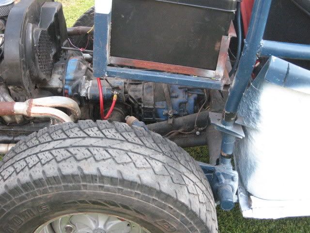

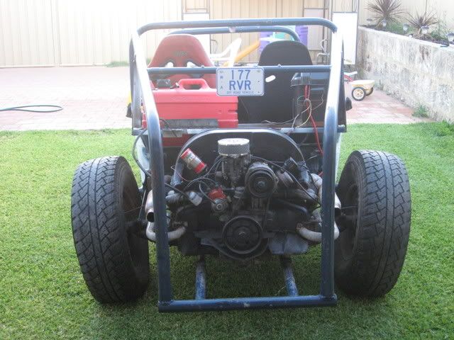

Well here are some pics I took of mine earlier tonight.
Hopefully these pics will help you out a bit. When you make your side intrusion bars, think about what seats you are going to use. Whoever made mine didnt think about that and was a pain in the ass trying to get something to fit.

WOW! thanks for the pics! Whats with the all the camber?
Post by D3V1L » Thu Mar 05, 2009 10:01 pm
same as my buggy..the camber comes from the swing axle gearbox when its jacked up

Yeah I finally bit the bullet and dropped it in last weekend. I see what you were talking about with the fuel leaking out the carby. Gonna swap that for the carb off the old motor anyway. Only other prob I found so far was the clamp that tightens the dizzy n position had a bent bolt and wouldnt tighten up. I swapped that off the old motor as well so thats fixed. Still have to stuff around with the drivers seat mount, and secure the fuel tank. Then I need mount points for my harnesses and tidy the wiring and she is all go.
Oh and put on my big wheels. :mrgreen:

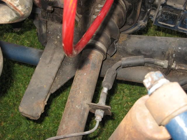

Post by Kappage » Fri Mar 06, 2009 9:33 am
Hey, sorry about this but can i get a photo form the underneath, i am curious as to where the bars that start at he back go under teh engine, where do they mount on the other end?
