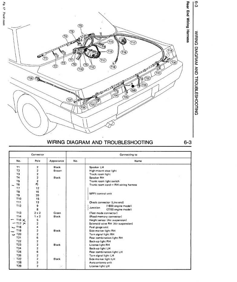

This is from the 1988 XT FSM
I did a similar thing to my Outback to convert the unused rear fog lights to stop lights
xt tail.jpg (95.78 KiB) Viewed 889 times
Post by steptoe » Mon Sep 26, 2011 8:50 am
I'll have to have another look/test of that T@ Truck Room Light connector - thanks Gannon. I did realise later models got same deal - lights and stuff all there just no worky!
