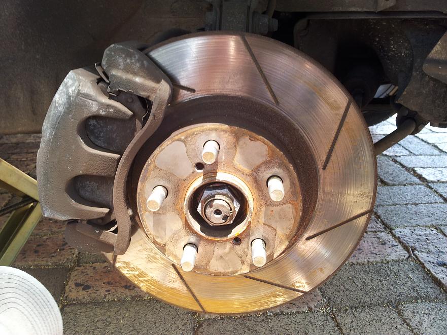

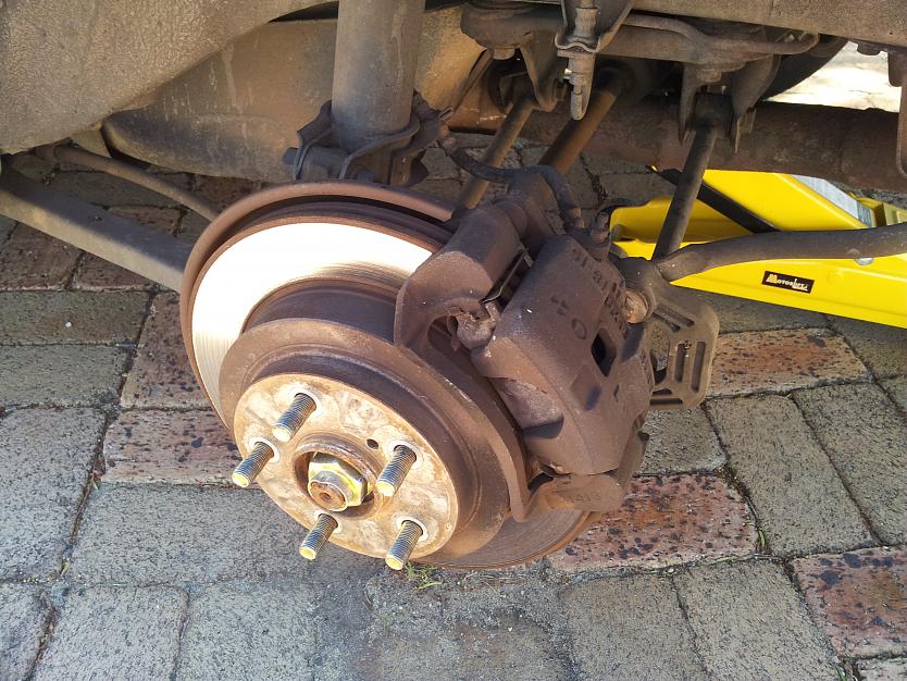

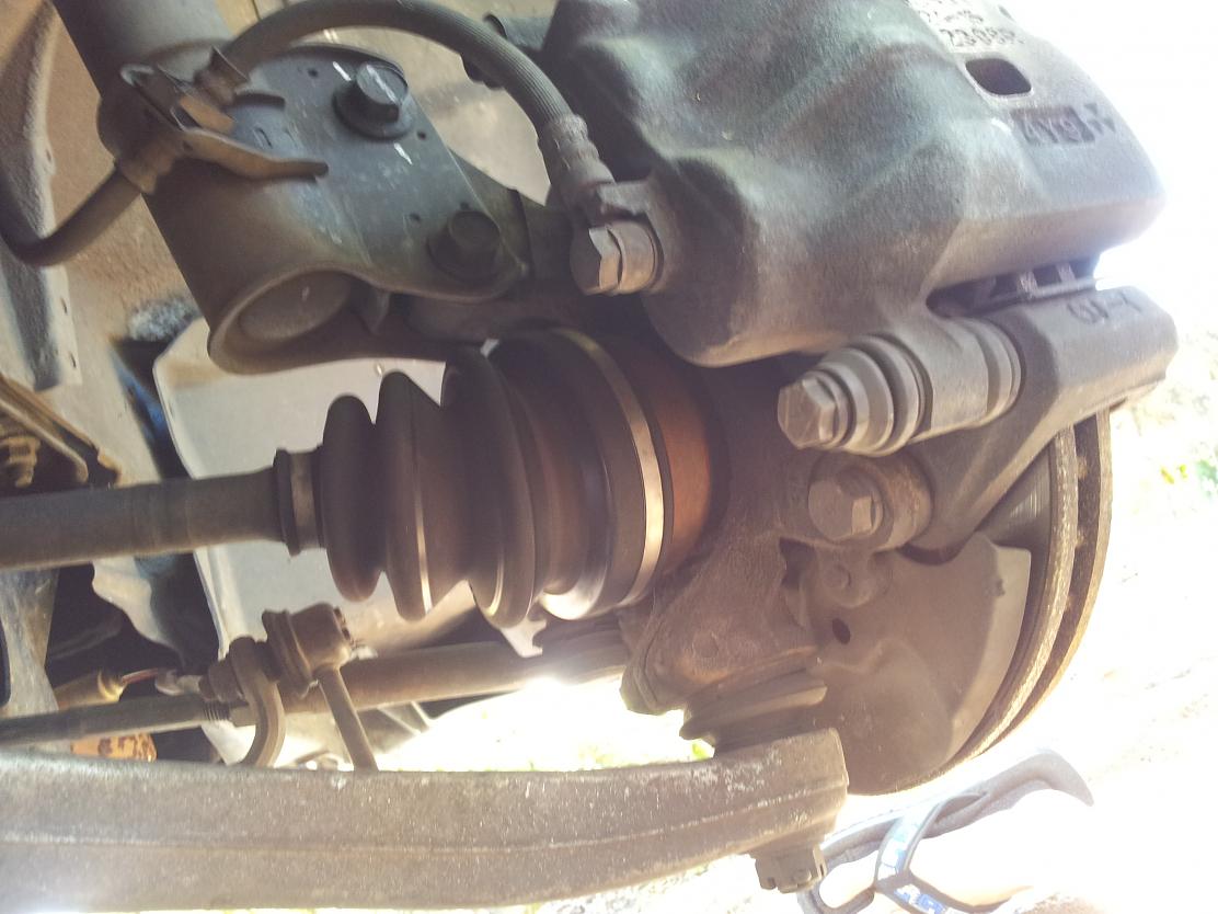

Gannon wrote:Can you take one front wheel off and take a few photos of the front calliper so we can confirm that the front brakes have been upgraded to 2 pot callipers?
Here is some photos of the brake caliper on the back wheel. Front wheel in the next post.

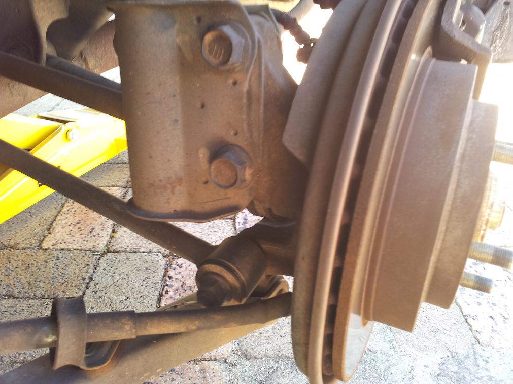

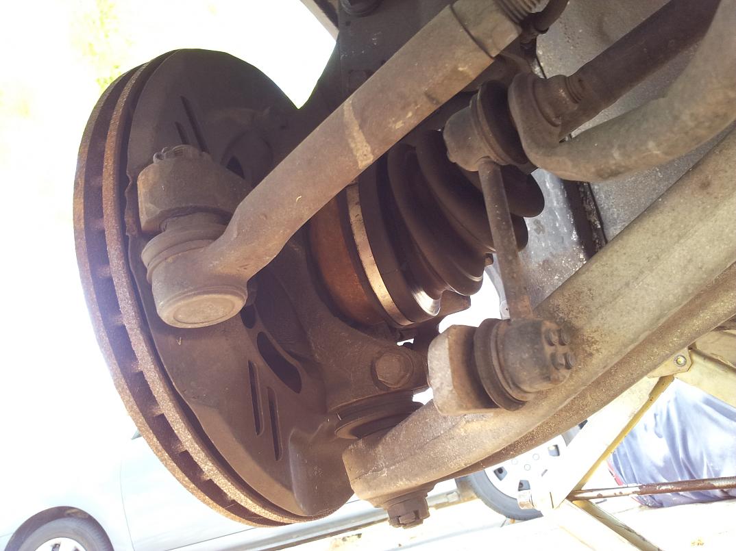

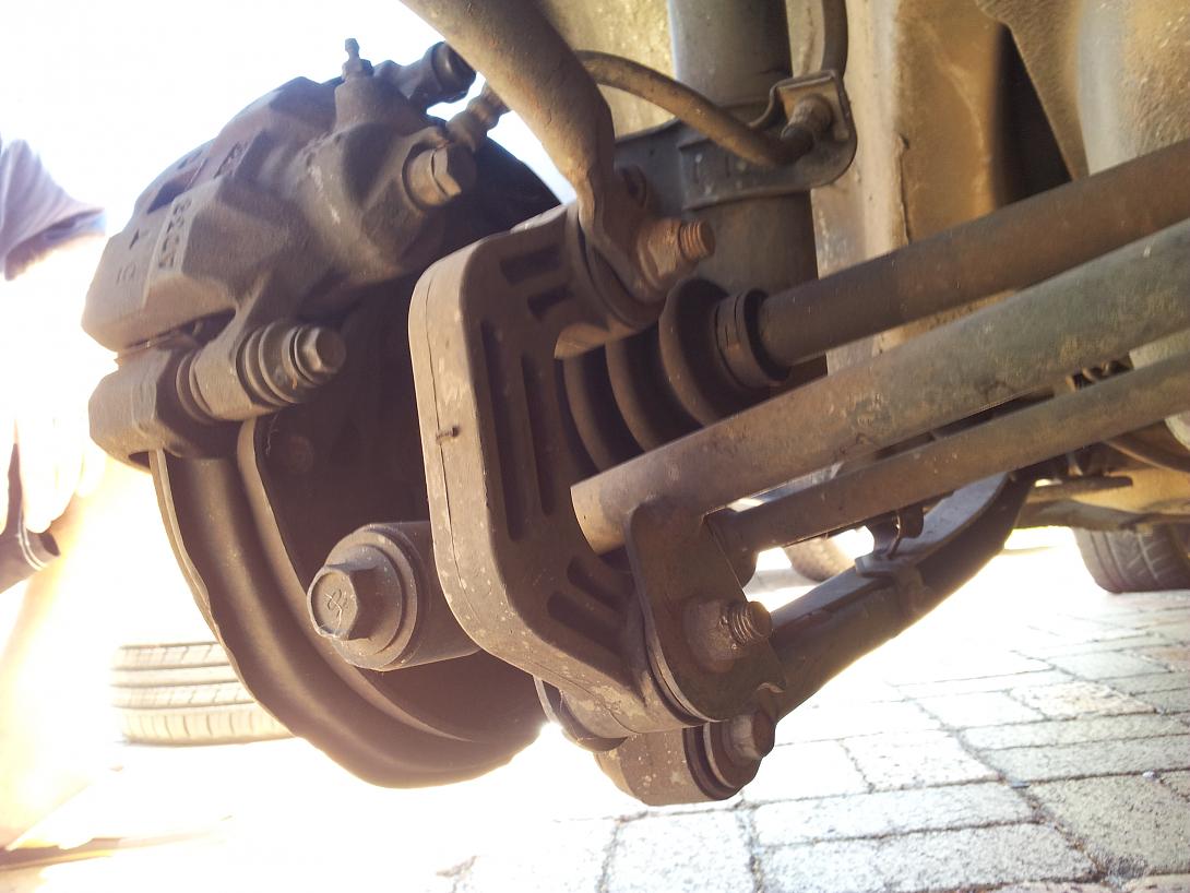

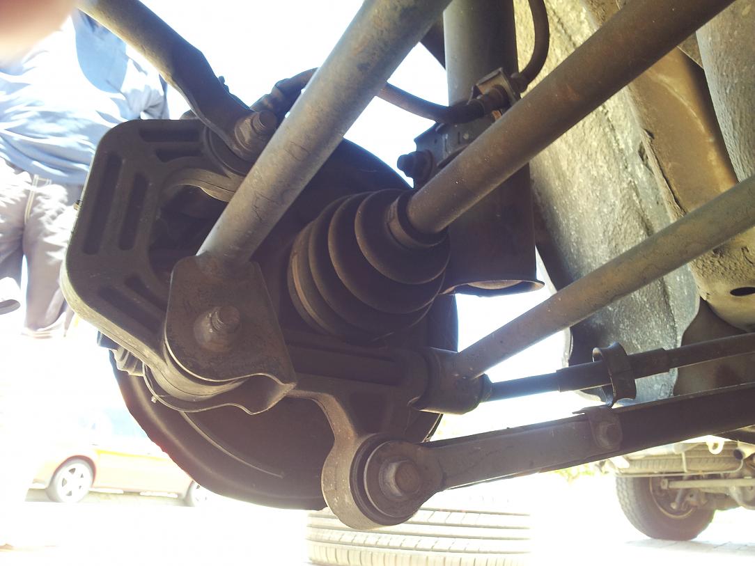

Post by Tomi » Sun Dec 30, 2012 2:53 pm

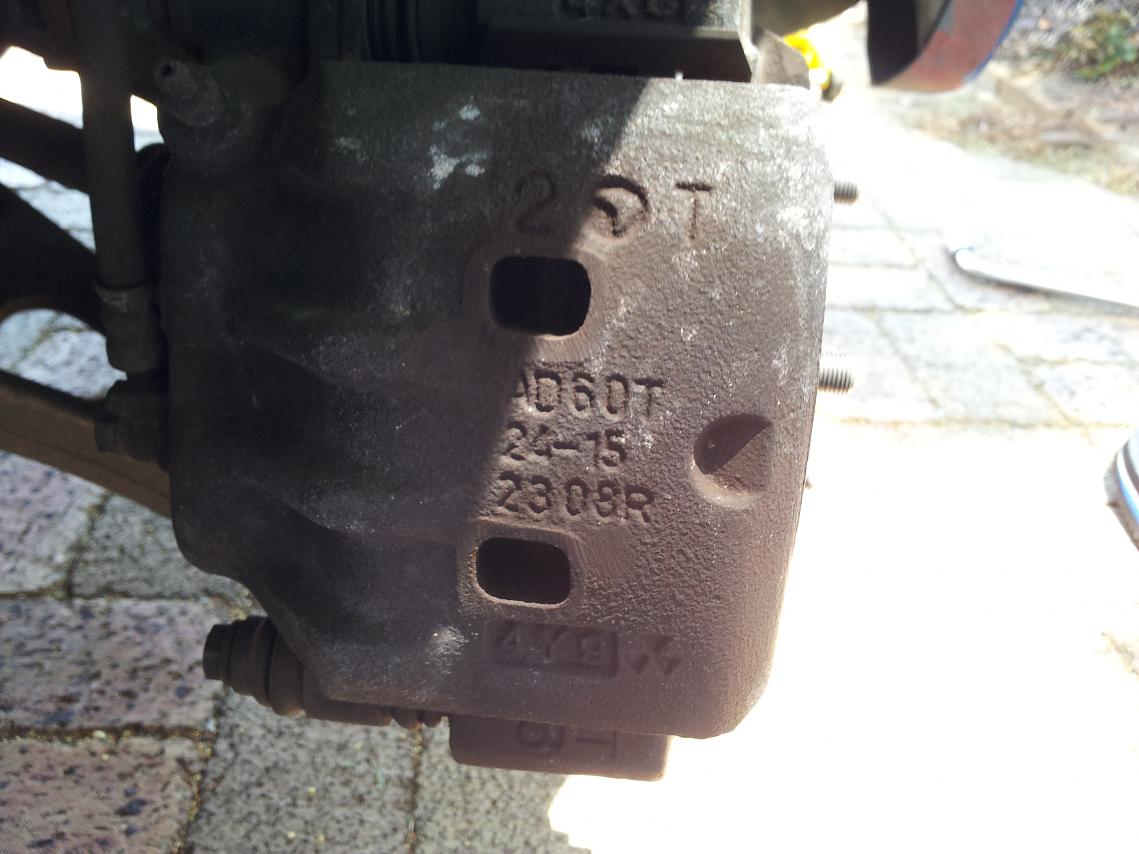

These are some photos of the brake caliper on the front wheel.

Post by nncoolg » Sun Dec 30, 2012 2:57 pm
Well it's possible it was an sti donor car or front cut as it has cast control arms.
Also it has vented discs on the rear, so proper turbo items.
# EA82 AWD 4EAT,
Post by Gannon » Sun Dec 30, 2012 3:23 pm
Good spotting of the alloy front control arms Nev! So parts possibly came from a STI front cut, so the engine could be an STI version.
And yes they are WRX brakes as they are 2 pots up front and vented in the rear.

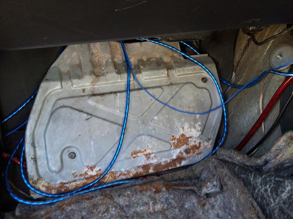

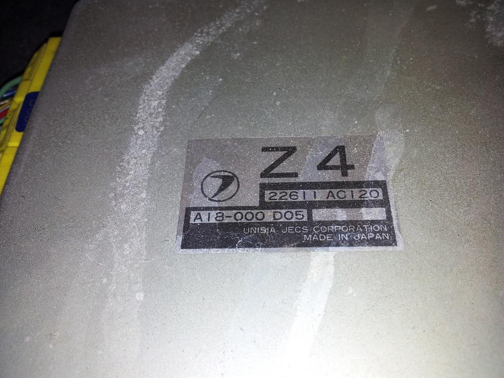

Can you tell us what the numbers on the ECU are?

steptoe wrote:I guess a part number off the ECU might continue the mystery unravel......
Where do I find the ECU?
Post by Gannon » Sun Dec 30, 2012 3:51 pm
Pull up the carpet in the front passenger foot well. There will be a large metal cover held with 3 bolts, the ecu is under it.

Post by Tomi » Sun Dec 30, 2012 4:12 pm
Here is a photo of the top of the ECU. Also, how I do upload photos that don't need to be click on to see them, like what Gannon just did?

Post by nncoolg » Sun Dec 30, 2012 4:17 pm
You need to use a third party image hoster and use the [ img ] code.
Is that red paint wet-rub residue on the ecu? I wonder if its possible the donor car was red like the front bumper?

Post by TOONGA » Sun Dec 30, 2012 4:42 pm
If you have uploaded the image to your album in your profile, there is an option under the image called bbcode. copy the whole code and paste it in the message/post. then the picture will appear in the message/post once it is submitted. if you upload it as an attachment to the post it will only be clickable.
The Z4 ECU is used in the WRX and or STI from what information I can find for it on google. (this is all from google so I take no resposibility for the reliability of the information)

Post by Tomi » Sun Dec 30, 2012 5:02 pm
Well here is a photo of the plate over the ECU as well. Also, there are red and blue cables running around the car everywhere, what are they for?

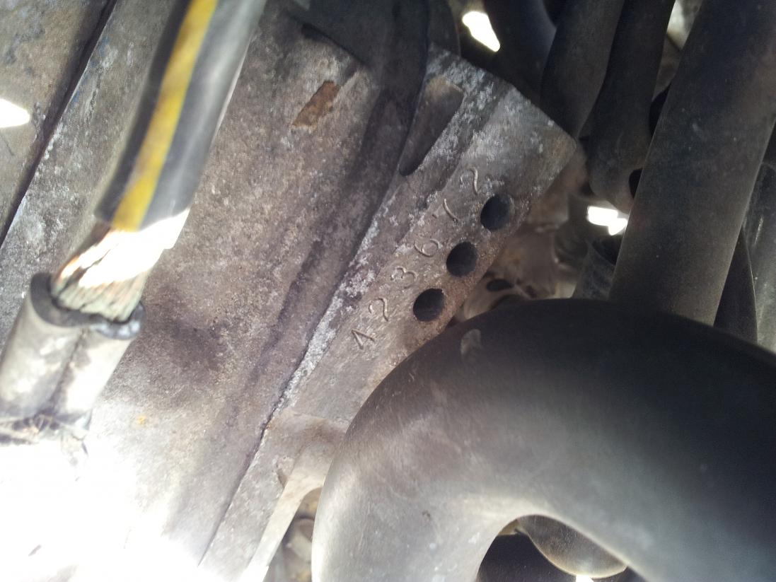

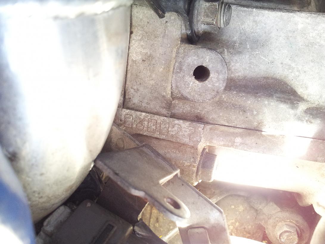

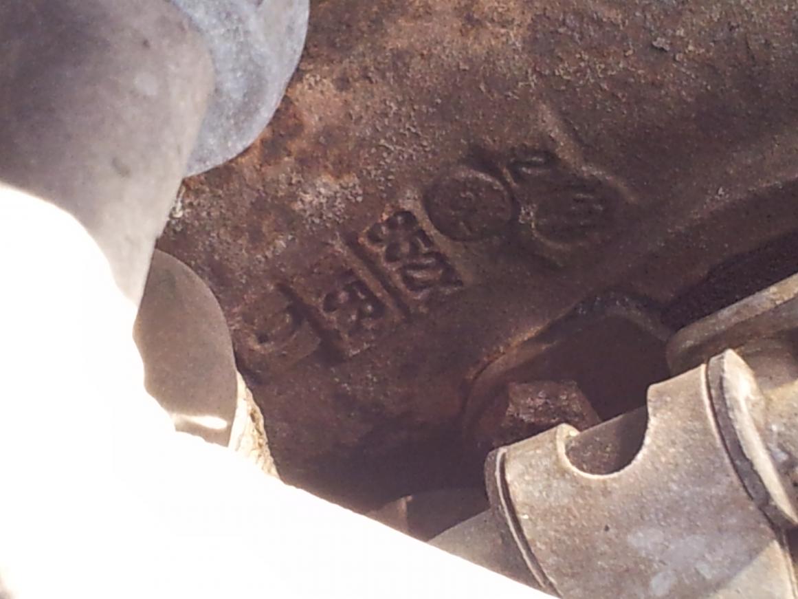

Also I still can't find the engine serial number. I'm not sure if these are it or not.

Post by steptoe » Sun Dec 30, 2012 5:06 pm
EJ's are funny with numbers but I think you have it up the back there starter motor side.
That thing you think is the turbo may just be the exhaust manifold in cast iron. I know very little about EJ and turbo versions of....
those cables of blue and red look like big stereo speaker cables oxygen free copper ??
Post by TOONGA » Sun Dec 30, 2012 5:11 pm
cables are for the stereo... I'm guessing the whole car vibrates when it is up loud.
this is your engine number
the other number is for matching the block halves.
Post by Gannon » Sun Dec 30, 2012 5:23 pm
Z4 ecu is 95-96 wrx and is slightly more powerful than the previous 93-94 wrx. Sti had a 6K ecu.
