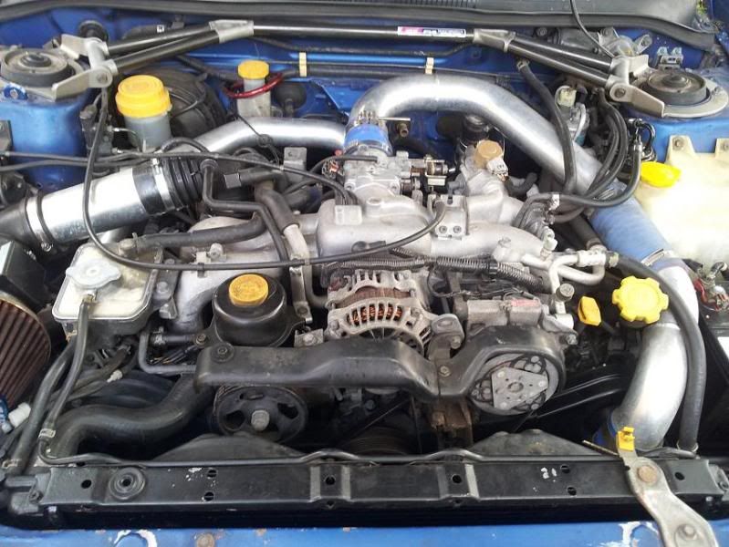

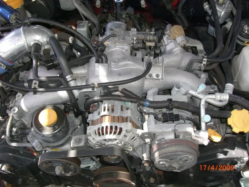

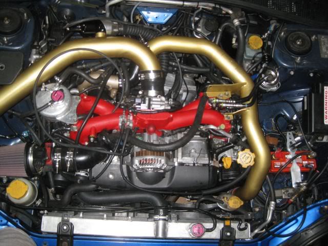

Congratulations, looks like you got a legit car with some nice mods but ...... the intake manifold from an 01/2 STI would not fit those heads as they have offset holes, I can assure you yours is a 94-96 from top to bottom, pics of my old offroader and yours.
Mine = same same
Yours = same same
02 STI, kinda sorta TOTALLY different lol.
