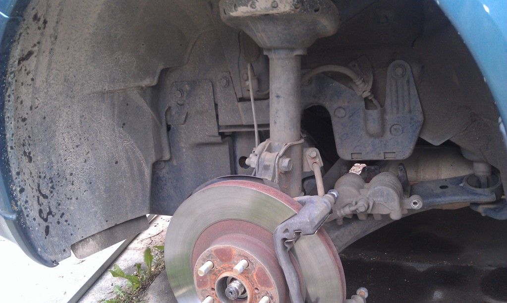

Upon inspection theres no splits in the boots however there is grease strewn all over inside the front and rear lh wheels wells.
Next i found a split in the lower knuckle on the LH side
So that will have to be replaced too now

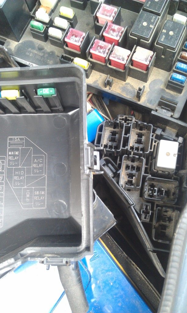

Then i put the car back together and got to researching online and came up with the quick fix and troubleshooting solution of placing in the fwd fuse.. Only theres a problem, theres no wires running into the location where the fuse should be.
Am i missing something here?
Post by Gannon » Thu Oct 25, 2012 8:16 pm
Is your Outback a manual or a H6 model?
The FWD fuse only applies to auto models with an MPT (multi plate transfer) clutch, which is the 2.5 models. H6 models have VTD (variable torque distribution) and manual cars have just a viscous LSD and thus neither have the FWD option

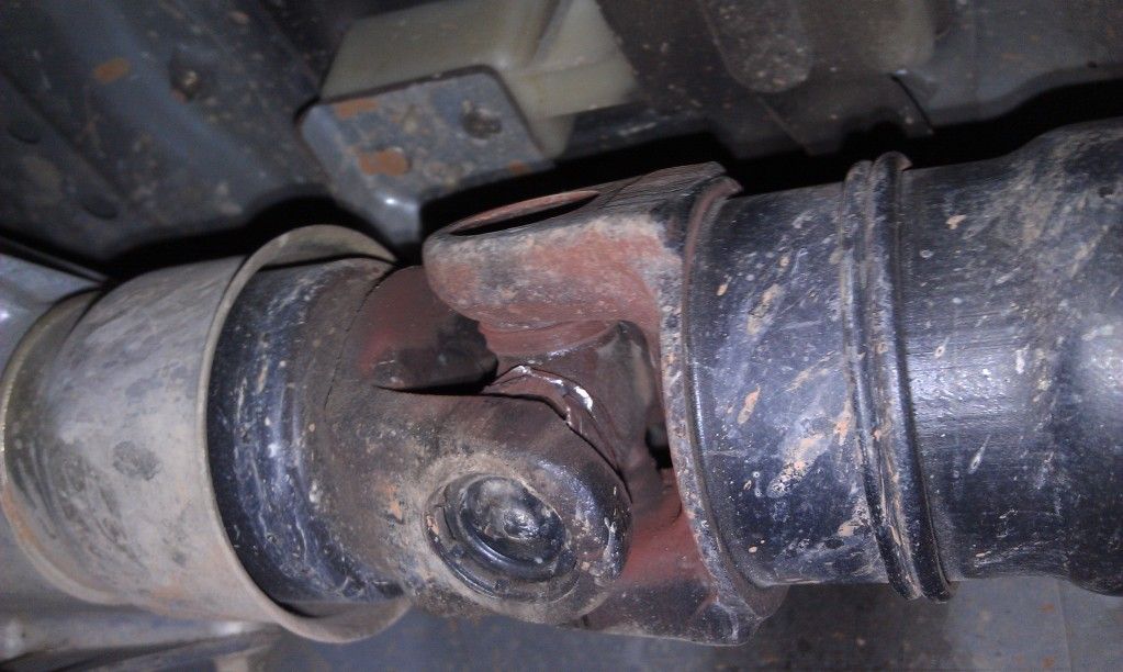

There is moverment in the driveshaft connection to the gearbox, to the point that i can grab the drive shaft and move it left to right etc.

Prop or tail shaft is the correct term - for RWD only vehicles they sometimes use drive shaft as well, but that gets confusing with AWD vehicles that have drive shafts between the hubs and the diffs ;)
But that said, that pic definitely shows the issue - and that's in really bad shape! Sorry to say that, but I think you're lucky you picked this up when you did. There must have been signs of this issue ages ago that you didn't pick up on. Venom had one go on our last trip and he noticed it before it got really bad - it was a dry bearing cup that was starting to fail due to the lack of grease. This was greased prior to the trip but the mechanic that did the work didn't put enough in and one was left without fresh grease...
You'll have to take that to a uni joint shop as they're pressed in unit joints. Get the whole shaft done while you're at it. Venom's prop shaft was modified to fit a uni joint from a mazda, a common part which was an RUJ1784.
It will probably cost a bit now, but if you ever have to do another one of these you'll be able to do it yourself ;)

After getting the tailshaft out this morning it appeared that the front uni joint was royally screwed while the rear was well on its way.
