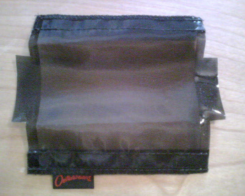

No air box at all on the Superu! Air is filtered by a custom setup at the snorkel head that consists of a piece of 3M coarse foam with a washable fine mesh filter behind it. Works great, easy to keep clean and cheap!
Also have the dyson style extreme conditions filter for heavy dust conditions, but the current setup usually suffices!
