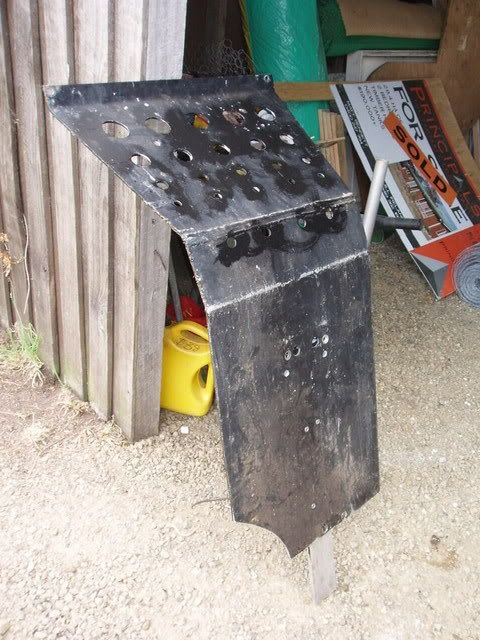

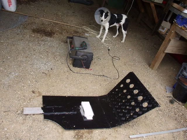

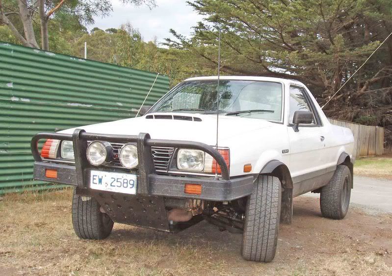

Another incarnation for the much modified and altered unit.
10mm alloy,
its about 1/2 welds now,
Matte Black of course.
1989 Subaru WonderBrumby II
Post by Alex » Mon Dec 03, 2007 1:55 pm
nice...looks tough.
good to see Groover gets in the pic as well!
MY_STI
Posts: 286
Location: Australia West
Post by MY_STI » Mon Dec 03, 2007 3:44 pm
Groover's on the mend and he still manages a cameo! What a dog.
Bash plate looks good as well, as does the gravel and the benches.
Keep up the good work.

It's got speed holes.

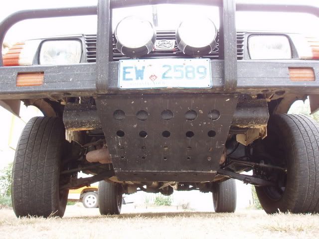

Post by AlpineRaven » Thu Dec 06, 2007 8:47 pm
Nice nice.. (I've thought of doing that as well) can you take a pic of what it looks like while under it?

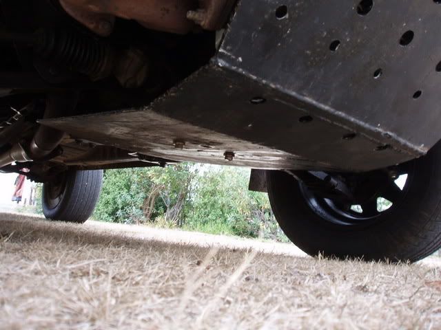

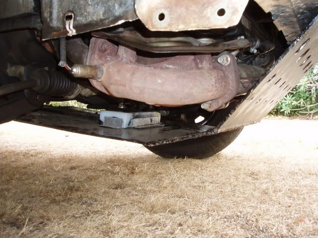

Post by BRUMBERTY » Wed Dec 12, 2007 12:28 pm

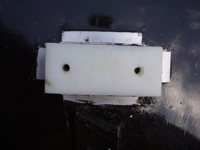

This is the crossmember mount...
I have bedded it in sikkaflex and the alloy surrounding it is secured the same way.
It is bolted to the bullbar at the front and the gearbox mount at the back.
The Spine strap is also sikka'd on.
I have snapped heaps of bolts in the past from shock, this time I am allowing a little bit of flex.
What the hell, busses are held together with it.
The weld lines hopefully will give it rigidity in the impact area..
But it is on...
Woo hoo.

just a quick question. do bash/skid plates need to have holes in them? for cooling or something? coz i got one made up by my bro and it hasnt got holes in it. should i get some drilled in or what???
if its not native its not cool.....
BRUMBERTY
Posts: 656
Location: Cranbrook, Tasmania
Post by BRUMBERTY » Fri Dec 14, 2007 9:49 am
Couldn't hurt Dylan, cooling is a big issue with subies.
They are reallly there to let the oil drip out.
