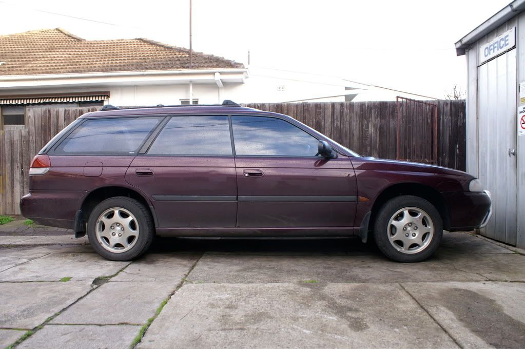

Today lifted my Liberty by using new set of KYB struts (bought on ebay a few wks ago, under name of Gabriel's (its packed by Gabriels but they are KYB struts as I checked the part nbrs etc & has stamped KYB on them, no where it has Gabriel's stamped at all) anyway installed them with minimal of hiccups - Rear was easy (lot easier than Sedan!) and front was okay-ish) just that spring compressor wasn't close enough, Will give measurements tomorrow,

Picture of before installation of Outback Struts.
Picture of after installation of Outback Struts.
