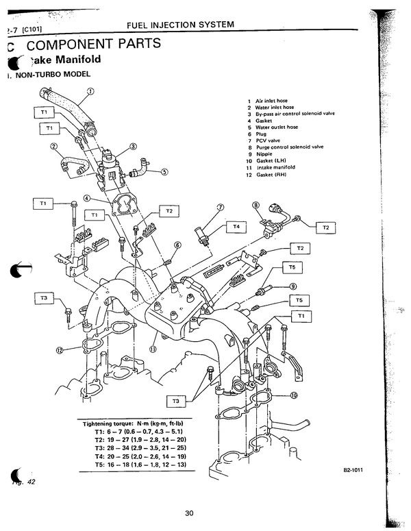

Ej22 seam to have Air Bypass Controller problems... is the engine light coming on when it begins to play up???
Either way i would be definately removing the Air Bypass Controller and giving it a good clean with carby cleaner. Just to be sure.

What is it, where is it and how do I experiment with the Air Bypass Controller?

hmmm u would imagine the light should be coming on when it begin running rough.
Maybe someone can help u out with a pic.
