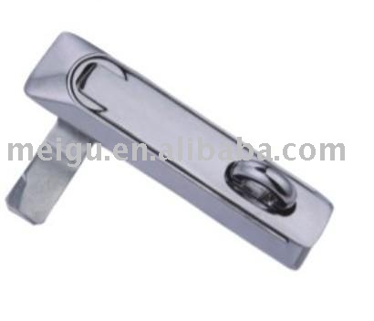

Would this help ?
swing_handle_cabinet_lock_with_padlock_device
Handle lifts, then turns to 'open'. After removing padlock of course !
They could be mounted either side, with a hook cut into lever - which engages the body or a clip mounted to tray ... :confused:

Another option ...
lockable_flush_lock_flat_lock
Or you could try this ...
T-HANDLE-HEAVY-DUTY-INDUSTRIAL-LOCK
Post by steptoe » Thu Nov 08, 2012 7:56 am
Hmmm....been sleeping on it, so too Bantum by the results - good work and thanks
Well, I reckon a thousand units would keep the box well and secure eh ? :D
Something like a u bolt bolted to floor to look like a n bolt, nuts topside and under, a neat slot in the base of the toolbox, with some reinforcement could be simple enough with unobtrusive upside down U bolts for when box not in.
To use something I thought like bonnet pins would require a slotted hole in floor ...think I will try a captive nut situation and O ring under th bolt head inside the box. I use O rings on trailer D shackle bolts so they remain tight yet fingers can undo them.
When whatever is done I'll com back in here to report .....
