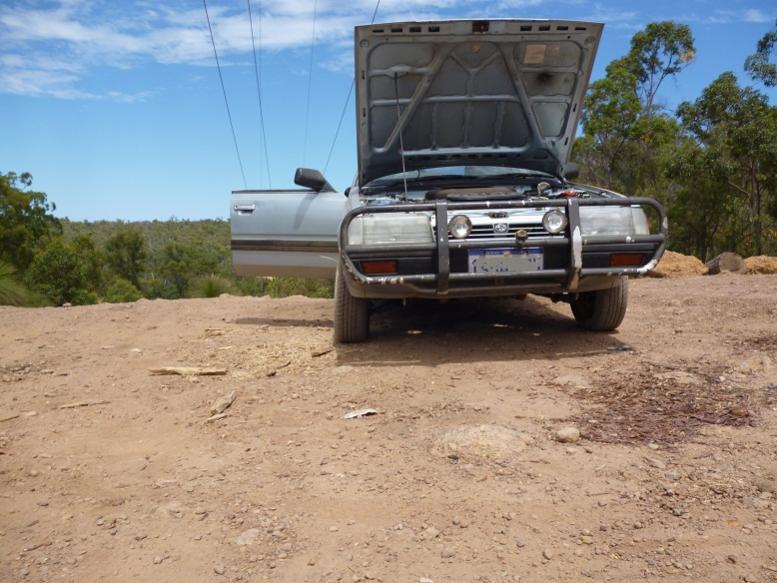

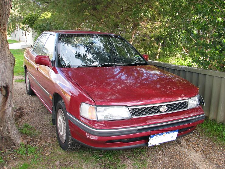

well, i went out to the powerlines with a hilux and a navara yesterday and the little L series came home quite sick. :(
they reckoned i wouldn't be able to get my car up one of the big rutted out walls... the good news, i did subaru proud and got up the hill...the bad, my front right wheel was bent out at the front and in at the top.
[ATTACH]3047[/ATTACH]
[ATTACH]3048[/ATTACH]
I crawled home, but lost drive to the front wheels on the way, i haven't looked yet but i suspect i broke a CV joint from the extra angle.
i suspect a bent shock, without looking to closely.
might put work on the EJ back a bit. the wiring harness is starting to thin out quite a bit now, and even better the lib still runs :D
also, i got a sports video camera which i had strapped to the roo bar 4wding, so if i figure out how i might put a video up of the hill that did the damage. there is a pretty sickening crack when it happened...

Post by TOONGA » Thu Dec 29, 2011 7:46 pm
KPM Guyph ... and it looks like the strut has collapsed and/or your radius rod has bent as well.
Post by RSR 555 » Fri Dec 30, 2011 4:23 pm
Nice work Robbie.. take some pics once you get that wheel off :)

Post by El_Freddo » Fri Dec 30, 2011 8:09 pm
Shouldn't be hard to fix once you've got the parts!
