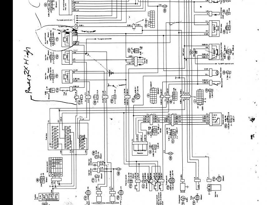

Not sure if this is XT ro XT6, but it may be of help
- XT fans.jpg (107.74 KiB) Viewed 2869 times
Thanks for your efforts so far kids
Uploaded with ImageShack.us
Is what I find all over the place. Gotta love the detail of Subies diagrams, so detailed you have to look in about three charts to get complete picture, diagram, wiring codes etc

Thanks Bennie, the diagram will be useful for future venturers
