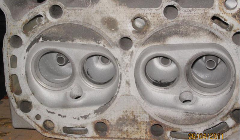

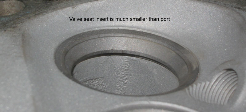

The EA81 has some very poor casting/maching alignment in the heads (see photos) which is easily fixed with the valves removed and carefull use of a die grinder with a rotary bure fitted.
The compression ratio std is 7.7:1, we take 1mm off the heads for aircraft use giving 10:1 ratio wich is not ideal for on the road, if say 0.5mm was removed the ratio would be aroud 9:1 but would necitate the use of 95-98 octane fuel and a little experementing with ignition timing.
BUT increased compression is not necessary for a reliable engine and the machining adds extra complication if you dont have acess to a lathe or mill.
